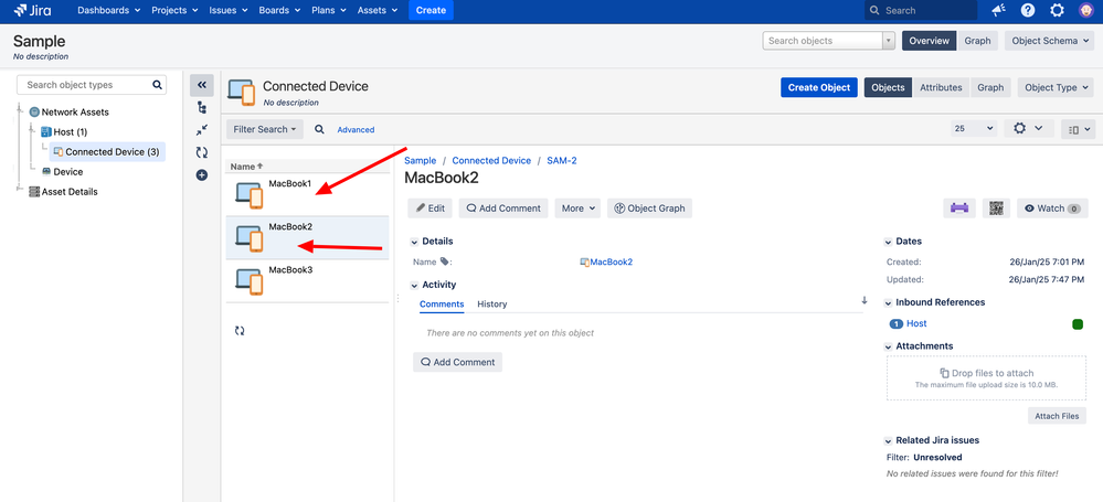

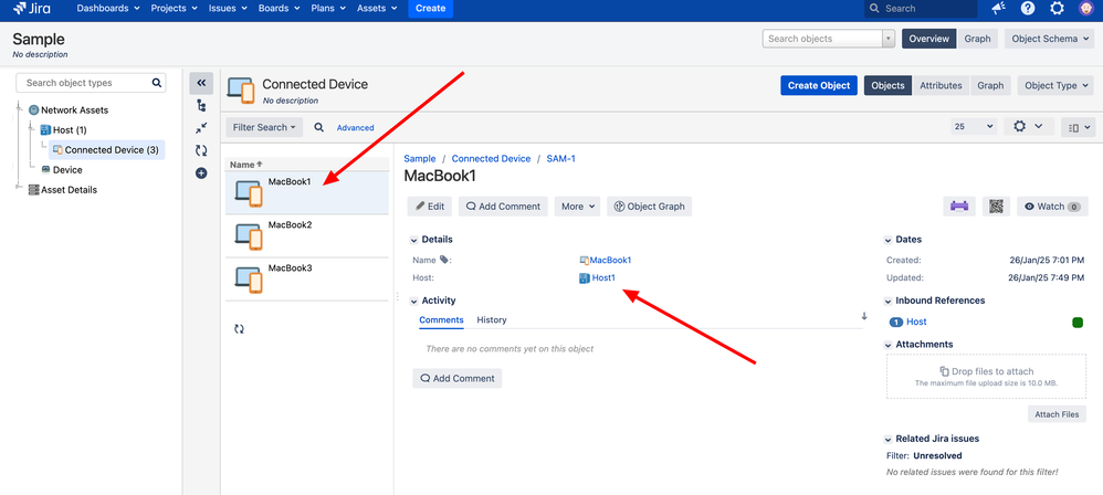

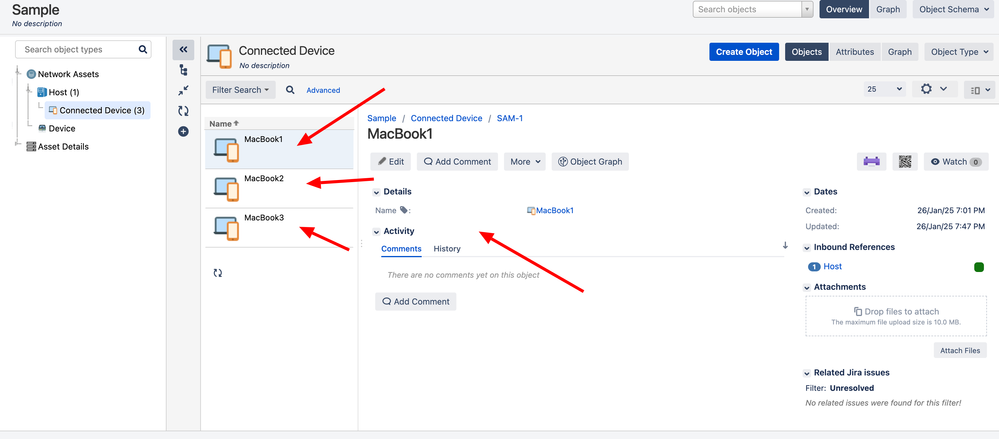

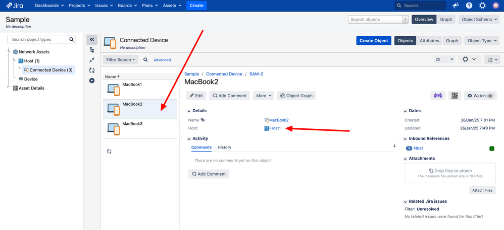

I tried a very simple test in my environment: a Host Server with Multiple Connected devices. I wanted to update the Host value in two of the devices.
Below is the sample working code that I have tested with:-
import com.adaptavist.hapi.jira.assets.Assets
def host = Assets.getByKey('SAM-4')
def referenceAssets = host.getReferences('Referenced Assets')*.getString('Key') as List
referenceAssets.each {
Assets.getByKey(it).update {
setAttribute('Host', 'Host1')
Please note that the sample working code above is not 100% exact to your environment. Hence, you will need to make the required modifications.
Below are screenshots before the Asset is updated:-
Below are screenshots after the code is triggered:-
If you observe the screenshots above I am able to update the value of the Host field in multiple Assets using the approach I have provided.
