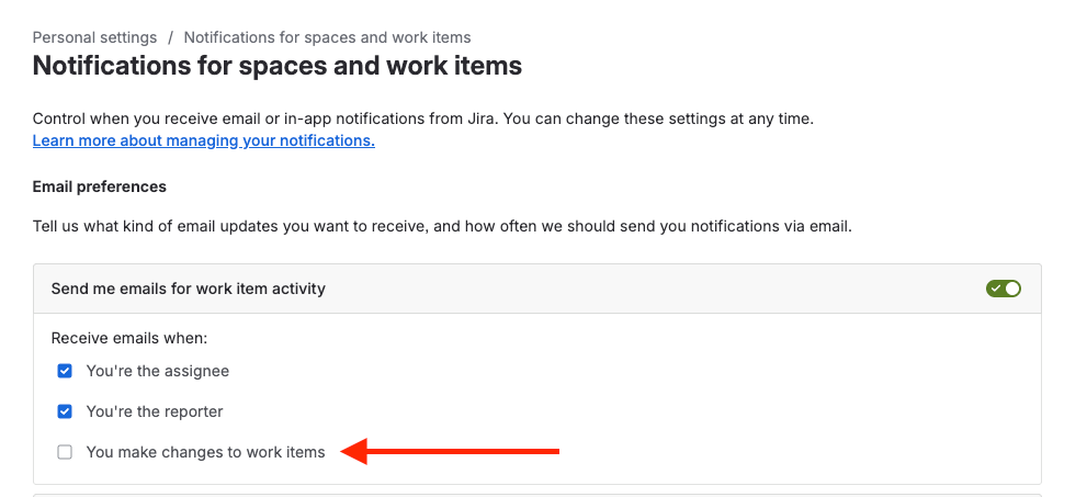

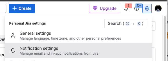

But Jira never sends out notifications about actions triggered by yourself.
That is not true. Jira does send those notifications.
However it is a personal Notifications Setting option to disable that.

Thanks for pointing that out @Trudy P Claspill .
I would never want to receive notifications for what I've done myself 😄
And it is disabled by default. So to aid @Jean Neethling: just make sure you either enable the Notification setting Trudy pointed to above, or have someone else test the form submit.

Jean Neethling
December 17, 2025
Heya,
Yes I have tried with this setting turned on, sadly no luck.
When I assign the request to myself I get a notification mail, but no mail when I am the one using the form to create an request.
