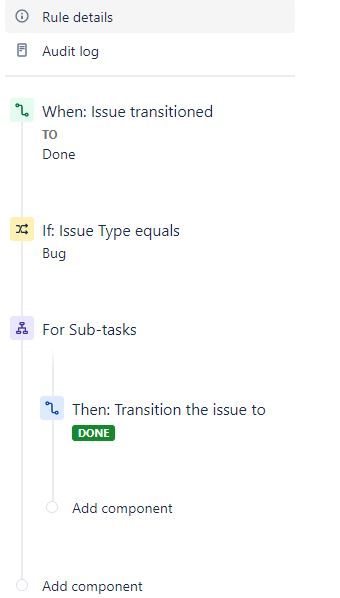

@Adam Rypel _MoroSystems_ Hi Adam - Now that the sub-tasks have a different workflow than the stories, I have an "accepted" stage for stories, which is the final stage.  The sub-tasks have a simplified workflow with "done" being the final stage. I am unable to complete a sprint since the subtask are still in the done state.  do you have a recommendation on how to remove the validator or automate a transition of all subtasks once the related story is "accepted"?  Thanks for your assistance!

Well all the tasks in the sprint have to be done in order to complete the sprint, so I am afraid you cannot remove that condition. You could map the Open status of subtask to Done column on sprint board (through "..." -> Board Settings). But I do not recommend that, since it does not really make "logical" sense to have Open status mapped to Done column.
As you say, you can use Automation to transition the subtasks to Done status. You can find Automation in the Project Settings. So you might create a rule similar to this:
Subtask needs to be in status, which can transition to Done status, otherwise the rule will fail. If you have "Allow all statuses to transition to this one" on Done status, then it should not be a problem.
To be absolutely honest, I do not recommend that either though - the users should learn to close their subtasks after they complete them, and without the automation, they just have to do that :) Of course your intention might be different and it is your decision.
