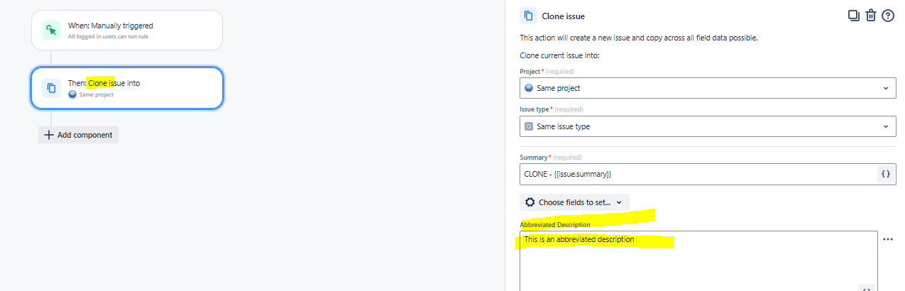

However, I want to make the "Abbreviated Description" field unavailable to any user to change and I thought that I could set the Show/Hide field to "Hide" in the Field configuration and remove the field from the Screens and that by running the Automations as the "Automation for Jira" user and therefore by default, the role "atlassian-addons-project-access", the automations would still be able to set those fields.  But obviously my understanding is incorrect because I get the error "Unknown fields set during clone, they may be unavailable for the project/type. Check your custom field configuration. Fields ignored - Abbreviated Description (customfield_14356)"
I know one way of doing this would be to set the Show/Hide field to "Show" in the Field configuration and just include the field in the View screen and not the Create and edit screens but this means potentially creating a lot more screens for different issue types in different Projects and I would rather avoid that.

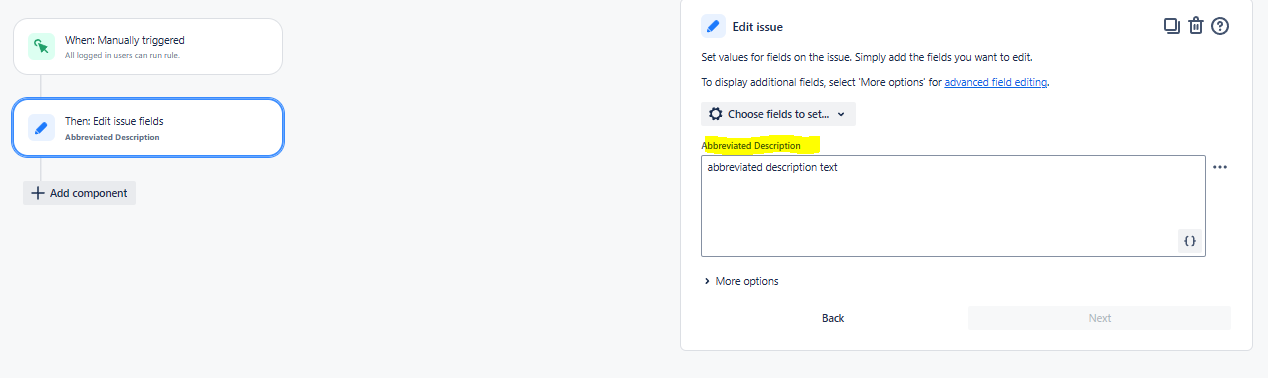

After some further testing, specifically, it is if I CLONE in the automation that I get the failure. So custom field is set to HIDE in field Configuration and is not on any of the screens for the issue.  The automations both run as the "Automation for Jira" user and therefore by default, the role "atlassian-addons-project-access",
The first automation works fine and sets the "Abbreviated Description" custom field when triggered.  But the 2nd automation, when manually triggered from exactly the same issue, fails with "Unknown fields set during clone, they may be unavailable for the project/type. Check your custom field configuration. Fields ignored - Abbreviated Description (customfield_14356)". Can anybody help me understand why ?pic1.PNG

Thanks - not sure I understand why the automation setting the fields on the issue works fine though but the automation cloning and cloning the custom field fails on exactly the same issue.
