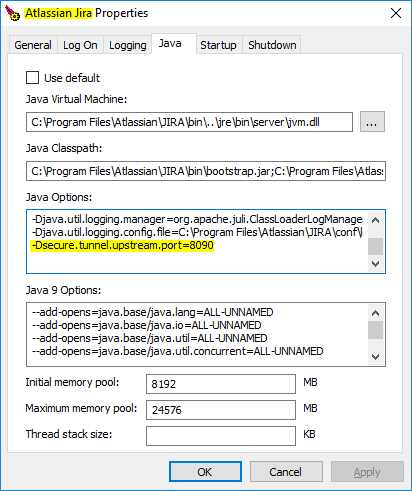

Hi Andrew,
The missing piece turned out to be a line in the service properties.
You access those properties by executing the following command:
"C:\Program Files\Atlassian\JIRA\bin\tomcat8w" //ES//JIRASoftware############
where JIRASoftware############ is the actual "Service name" of your Jira in Windows Services - you can get it via this PowerShell command:
Get-Service *Jira* | select Name
Of course, also make sure you are using the correct path to your bin folder...
Once you get to the service properties, switch to the Java tab and in the section "Java Options:" add this line:
-Dsecure.tunnel.upstream.port=8090
Restart the Jira service or reboot the whole server - after that, the tunnel should work.
After a Jira upgrade you will need to add the changes in conf/server.xml and in the Java options again.
Regards,
Dan
