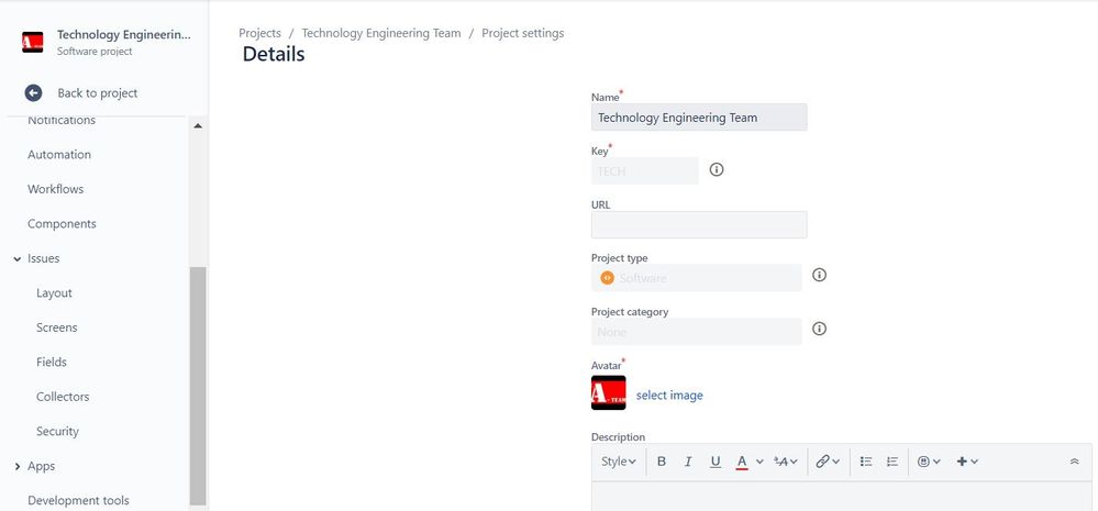

Is it possible to share some screenshots of your project config?
Hi Dave,
I am getting 404 error when I replaced the Issue Type URL with my sitename.
Attached screenshot of my the project for reference.
Thank you, for all your support.
In that case, I would like you to contact your Jira/Site Admin who should be able to change the configuration for you.
