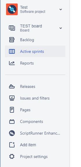

These are all the options I can see in the project settings for projects in Jira Software, and I can't find any permission scheme within any of these options. I can see a lot more settings in Jira Service Desk. Could the issue here simply be that I haven't been given high enough admin rights within Jira Software?

You need to go into the specific project and look for settings, like this example:
André Johnsson
February 27, 2020
Sorry, I should have been more clear. That view is from within the specific project after clicking "project settings" :)

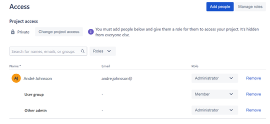

Ah, looks like you are using a "next-gen" project.  What do you see under the "Access" link?
André Johnsson
February 28, 2020
This is what can be seen under access:
Pete Singleton
February 28, 2020
Ok that's a next-gen project, so doesn't have Permission Schemes like classic projects to.
I'm not too familiar with them, but I notice it is marked as "Private" at the top, so that may be preventing it appearing in the list?
