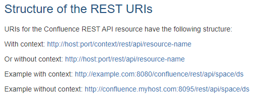

At the top of the documentation it is mentioned:
Tried your suggestion, but then I only get a "page not found".
With the code above I can read the json file stored(created with postman and with "rest/api/".
