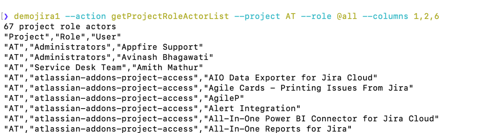

Hi @angela ,
With the help of Jira Command Line Interface (  ( https://marketplace.atlassian.com/apps/6398/jira-command-line-interface-cli?hosting=cloud&tab=overview), you will be able to achieve the above requirement.
1. Using the ACLI action below, you will be able to list all the project members for a specific project.
--action getProjectRoleActorList --project AT --role @all --columns 1,2,6
2. you can also use the below acli action to write the above data into the CSV file.
--action getProjectRoleActorList --project AT --role @all --columns 1,2,6 --file userslist.csv
3. By using CSV, you can create bulk issues using acli. Please refer below article for more details.
https://appfire.atlassian.net/wiki/spaces/SUPPORT/pages/89144847/How+to+create+issues+in+bulk+from+a+CSV+file+using+Jira+Command+Line+Interface+CLI
