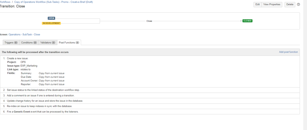

I am having an issue with the "Create a new issue" post function.
Despite several attempts, I can not get the new issue to fire.
It is important to note:
1. The post function is on the close transition (anything going into close)
2. The original issue is a sub task and I am trying to create a new task (not a sub-task) in the same parent type but a different issue type
3. There aren't really any conditions to this create-issue-transition, but rather it should happen every time the sub task moves into "close"
4. Also, after editing the workflow, I did published it. ;)
See screenshots for more detail.

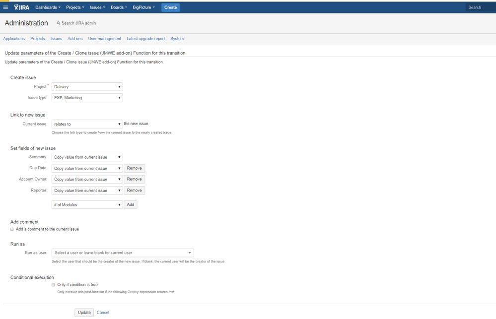

 Yeah I thought of that, I do have required fields and I am coping them over from the subtask. They are called out in that second screen shot (due date and account owner).

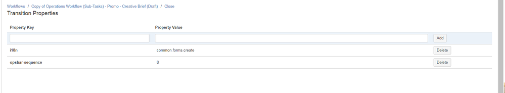

Could it possibly be something with the properties?
To create an issue (the issue I am trying to create by closing the subtask) these are the properties:

As a test, could you make the "Account Owner" field not required in the target project then try again?
Brooke Musat
May 1, 2018
That totally worked. Are you thinking it is because the account owner field is a custom field?

 I don't have any experience with the Jira Misc Workflow Extensions add-on so I am not sure how they handle custom fields. Are you able to use the field ID in place of the field name?
If not, then you may want to contact the JMWE vendor for further troubleshooting.
David Fischer
May 2, 2018
Hi @Brooke Musat,
JMWE does handle custom fields, except those of a few types implemented by add-ons that do not implement required Jira APIs.
But are you sure the subtask always has a value for the Account Owner field? Otherwise copying an empty value would not satisfy the field's requirements.
Also, what is the field type of the Account Owner field?
