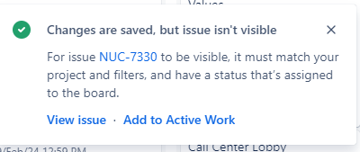

Thank you Laurie and Nic. I created a dummy issue to inspect Jira's data flow and observed this prompt. I did not click Add to Active Work (Active Work is the name of our sprint). The other person's issue I was describing above, MUST have selected that option. A brand new issue defaults to status of BACKLOG as stated earlier.
Next logical question then is how can I remove the "add to active work" as an option? If anyone has a quick comment that'd be great - else I'll open a separate request here.

Nic Brough -Adaptavist-
February 13, 2024
I don't believe you can remove that.
