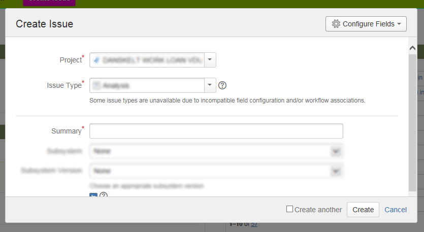

 You get a pop-up window to create issue

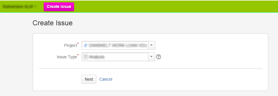

Or "screate view" window divided in two steps
step1

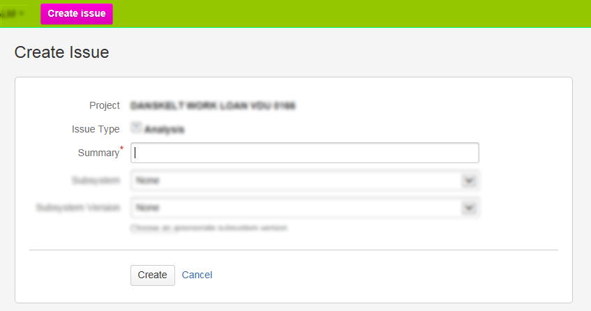

step2

when you create an issue the 'create' screen, if you have one defined, will be shown. If you don't have a separate create screen the Edit screen is shown.  The Step one you show is when you select the project and issue type from the main screen. After you select those the Create issue screen from the appropriate project/issue type is displayed.

All screens are defined, but when I press "Create" button when I am at dashboard I get pop-up window (that is good, i whant that).

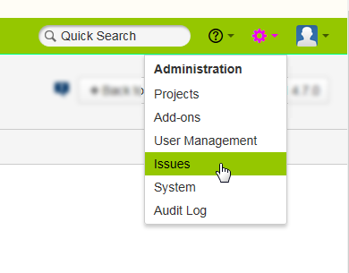

But when I am at jira Administration > Issues (for example) settings
and press "Create" button I get two step approach.
But I would like always to get pop-up window.
