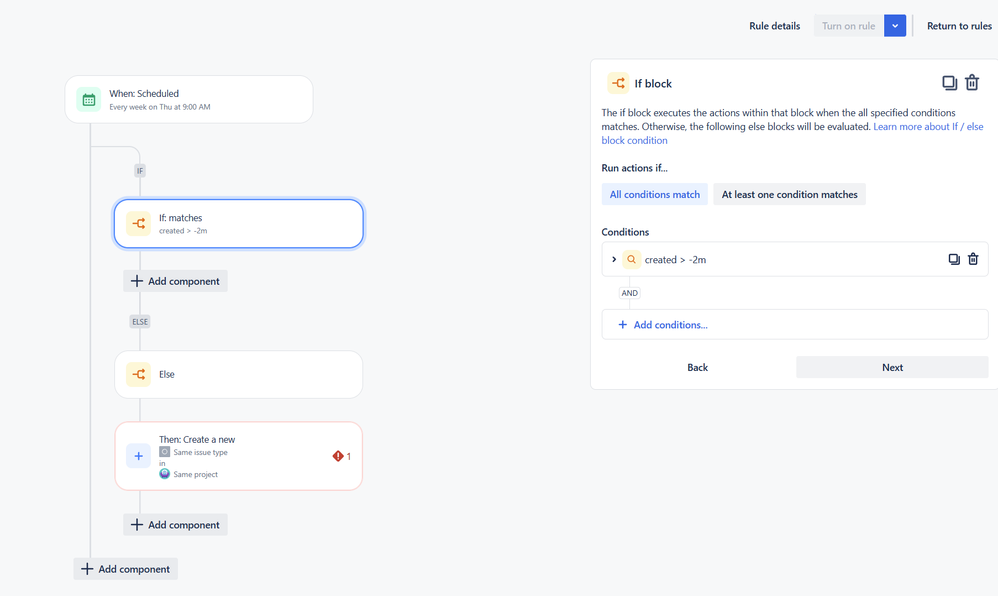

Hope it helps

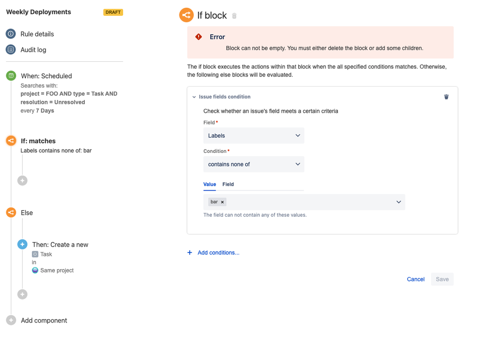

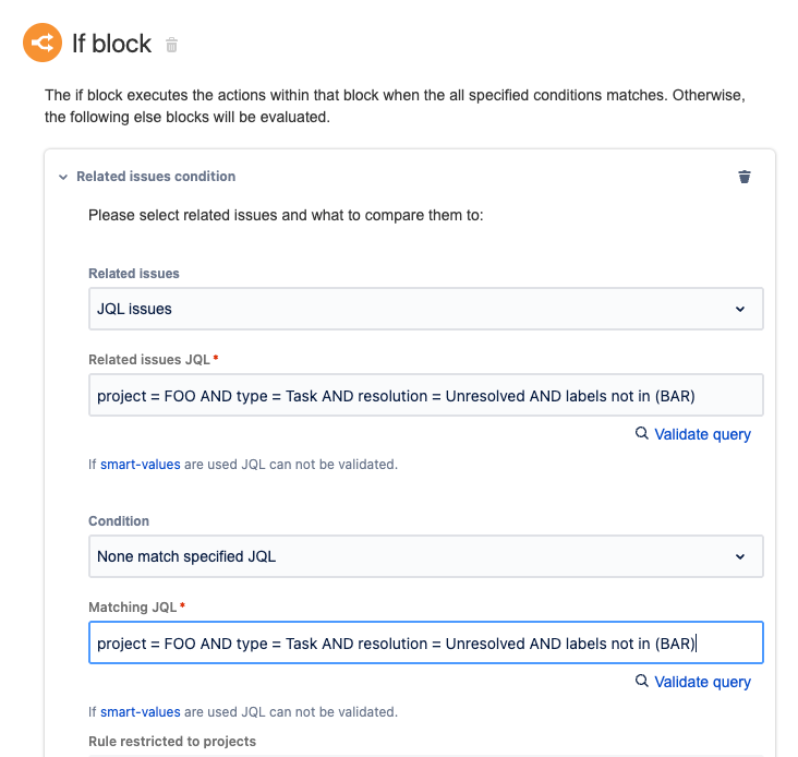

Thanks. I tried something similar for my version but get an error that block can't be empty.

Hmm.... it's not working because there are no matches I think.
For example:
1. The first When query finds 4 tasks that are open.
2. Then it looks at those 4 tasks and sees that none of them have the label bar, so it sends an email. There are no remaining issues at this point for it to create a new task.

Brad Prusa
January 22, 2025

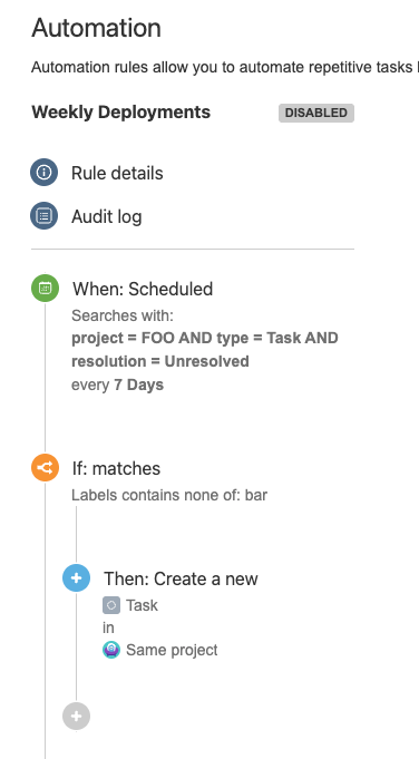

Yes, I've tried many different ways: if statements, if related issues condition with none match JQL matching non condition. It seems the issue is because automation finds no results, so there isn't an action to take without a match.
It looks like we are using Jira Project Management v9.12.12

I think you're in the right track, you just need to invert the logic to the else block - as jira works mostly on iteration over tasks, and don't naturally support querying "lack of tasks".
Try this same setup but in the else block, with something un-impactful such as log action in the if-true block
Brad Prusa
January 22, 2025
I'm not following what you mean. I'm starting to think this isn't possible because if there are no matches, then nothing is triggered.

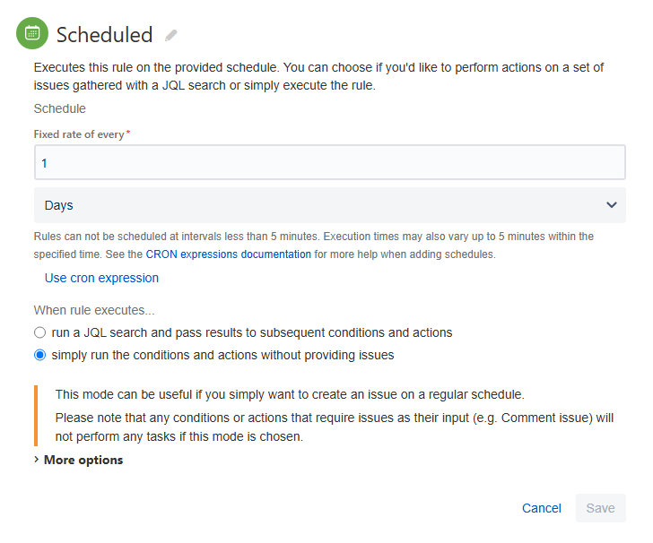

I recommend a different logic to the construction of the rule.
You can still use the Scheduled trigger, but don't include a JQL in it.

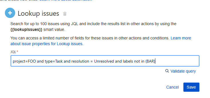

Follow that with a Lookup Issue action where you execute the JQL that would find the issue, if it existed.

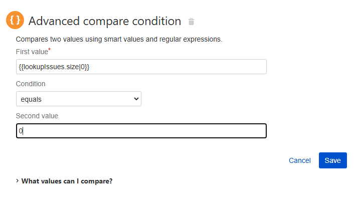

Follow that with an Advanced Compare condition to see if the results of that Lookup Issues was 0 issues found.
