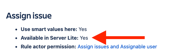

If you are using Jira Server then you must be using the plugin Automation for Jira - Server Lite.
Unfortunately the functionality needed to achieve your goal is not available with that plugin. The functionality I'm thinking of is the Advanced Compare Condition that would allow you to compare the Timespent+RemaininEstimate total to the Original Estimate.
Yes, that is what I meant.
According to the documentation that is available only in the full Automation for Jira Data Center plugin. Perhaps you have Data Center rather than Server.

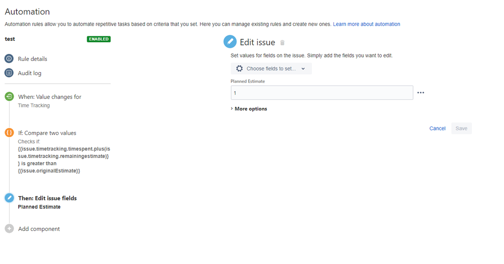

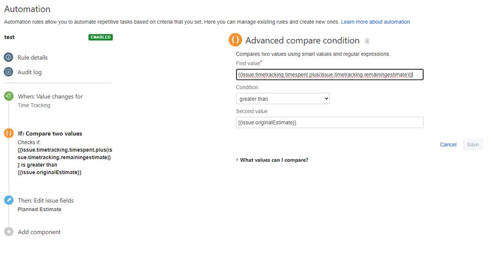

Hi @Trudy P Claspill ,
we do not want to use mail - so I had the idea to fill a new custom field with a marker and filter than for that field. Maybe it's not the perfect way but I wanted to test the logic first.
I've tried to use your example but it doesn't work. Do you know why?

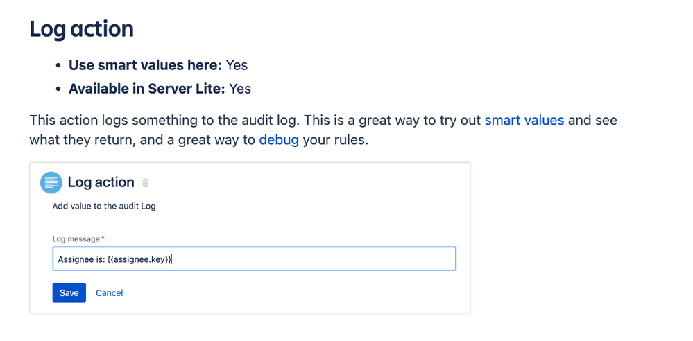

I recommend that you use the Log Action to write into your rule execution log file the values for each smart value you are using in the comparison:
{{issue.timetracking.timespent}}
{{issue.timetracking.remainingestimate}}
{{issue.originalEstimate}}
Use that to make sure that the information being used in the rule matches your expectation.
It is possible that I don't have the smart value names exactly correct. I don't have a Jira Data Center instance to use for testing.
@Trudy P Claspill Sorry, I don't yet understand what you mean by using Log Action :-( Can you give me an example please?
Refer to the product documentation that describes the available Actions:
https://confluence.atlassian.com/automation/jira-automation-actions-993924834.html
The Log action can be used to add message to the log entry created when an Automation rule runs. You can use it to print smart values and messages in the log file as a method to debug your rule.

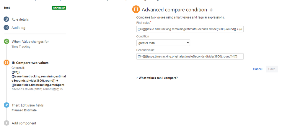

Hi Trudy,
that helped me, thank you!
I then realized that it works best to calculate the times as simple numbers to fill my required field with 1 or 0. I would then look further :-).
