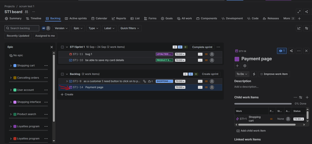

1- I wanted to create higher hierarchy level above the epic so I created a work item type called pages with hierarchy level 2 as below:
2- when created work Item a work item using the type "Page" it shows up in the backlog as below:
3- I managed to add the epic as child of the page created as above image.

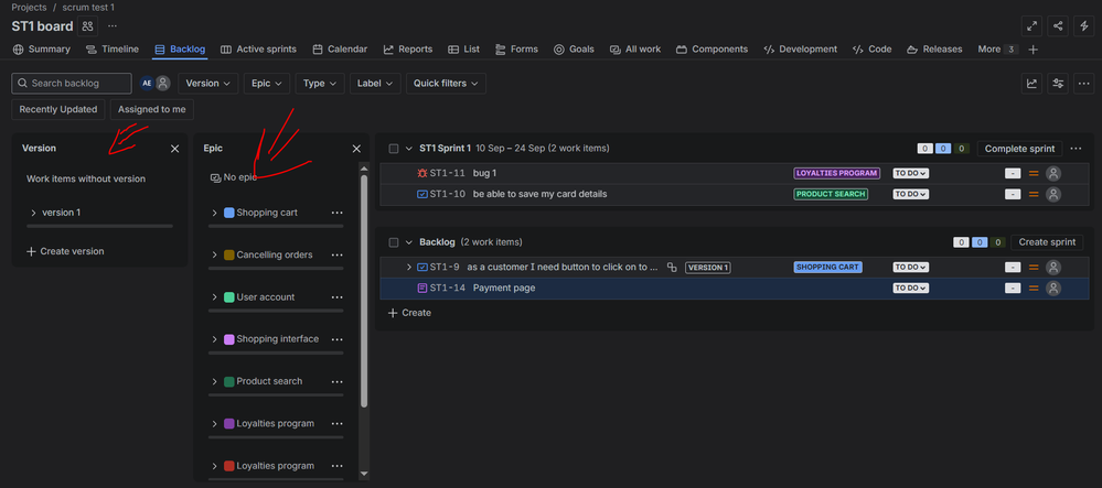

4- the main thing I need is to have the pages in open box similar to the epic & version boxes as in the below images, so when I create a work item using type "page" it doesn't show up below the user stories or tasks and it appears like when I create an Epic:

Hi @Ahmed Essam , thanks for the explanation.
As I said, you can (and have) created a custom work item hierarchy but it is not possible to make the custom work item type of Pages have a panel, which is reserved only for Epics.
A possible workaround would be to create another board for your Pages but I appreciate that isn't ideal.
You could create a Plan for this project / board to see the hierarchy. Would that help / work?
