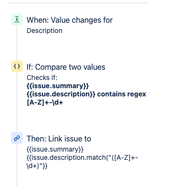

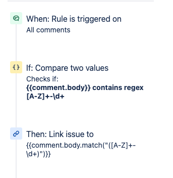

I had in mind to make it like this, but then just try to replace the comment values with values from the description. Eventually this wasn't really working as I had no idea which values to check:
but this is of course nothing but an ugly copy with some (probably dumb) assumptions based on the comment rule that created link issues on smart objects.
Later I also thought, that you don't want existing links to be made double.
For example, you edit the description again (for example) add another smart link), then you don't want all already existing smart links from the description which are already linked issues (related) to be linked again. That could create a lot of double linked issues hehe...not sure if Jira is taking care of this part themselves to prevent this?
And this is what I tried to make of it after you wrote me the info above. But I have the feeling that I didn't really get it..

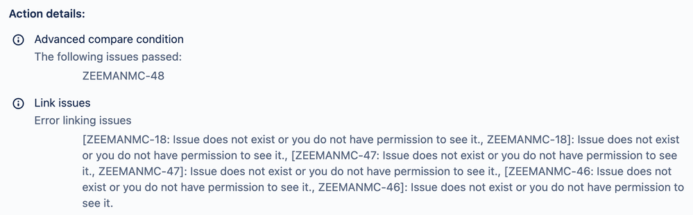

The audit log also says I made mistakes hehe
before adding the issue summery the audit log already didn't like the second part:
Failed to get value for issue.description.match("([A-Z]+-\d+)": {{issue.description.match("([A-Z]+-\d+)"}}
Of course the summary field in here makes absolutely no sense when checking on a description change..but I forgot to remove it before making the screenshot. so forget those summary fields in the issue...then you still the get the error mentioned in the audit log.
I am totally lost....sorry

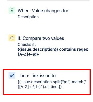

So perhaps try this using that regular expression to split on lines and to remove any duplicates add distinct:
{{issue.description.split("\n").match("([A-Z]+-\d+)").distinct}}

The audit log doesn't show any updates since then.
I have applied the rule to a test project only but when creating or editing the description of an issue, no new additions to the log are added.
I now do see some errors in the log, when applying your example with distinct:
The audit log now says:
I hope you have an idea what this last issues is.

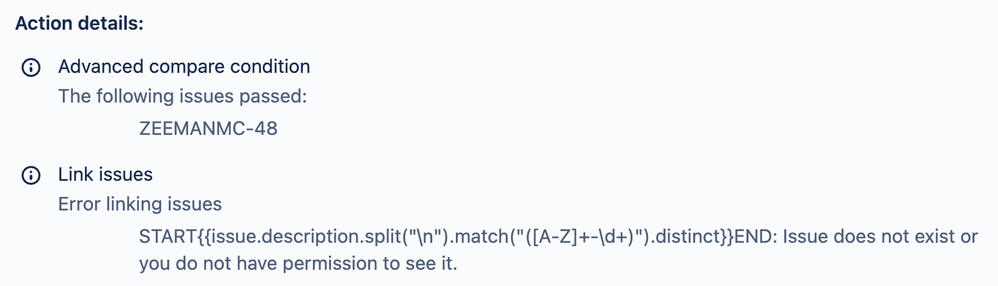

Please try writing that smart value expression to the audit log prior to the link action.  That may indicate if it contains what is expected, or if there are any stray characters.  For example:
START{{issue.description.split("\n").match("([A-Z]+-\d+)").distinct}}END
Will show if that contains only an issue key between the START and END text.
Owen Schikhof
May 5, 2022
Still an error which is not getting to help me further:
It doesn't really make clear to me if that split function is working properly.
The description only contains 1 issuenumber as a smart link.
Wanted to try it with 1 link first before putting more in..

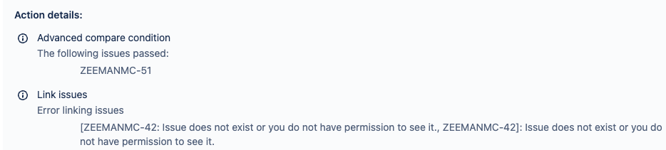

Owen Schikhof
May 5, 2022
When I put 3 smart links in, with a tekst somewhere, the detection of the tickets seems to be ok....but the error keeps being the same about permissions or not existing. Screenshot 2022-05-05 at 13.29.17.png
I am confident all permissions are as they should be, so it must be something with recognising the smart links as valid issue numbers.

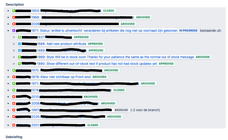

Owen Schikhof
May 6, 2022
Hi Bill,
This is an example of how our tickets are setup:
I striked through some info that might be too private ;-)
gr. Owen
Bill Sheboy
May 6, 2022
Yup, that will work with the syntax I provided to parse by smart-link.  I just tried it with and without bullets to confirm it identifies the keys and adds the links.
