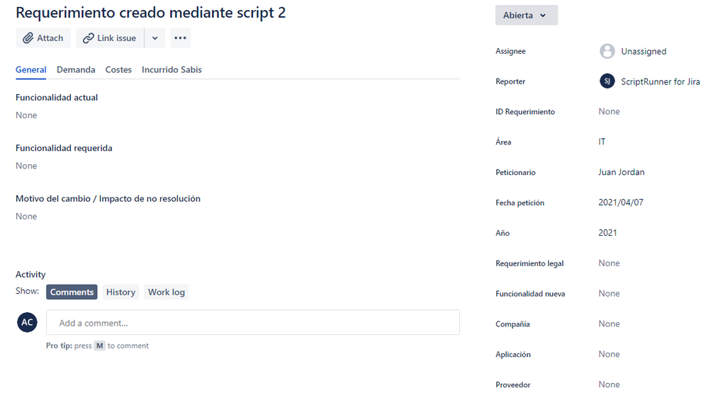

Hi, I'm trying to create a new issue and I have to inform the mandatory customfields. When I try to infrom the multiselect custome field appear this error message:
{errorMessages=[], errors={Compañía=Specify the value for Compañía in an array}
In the next link (Jira REST API examples (atlassian.com) I found that the correct form to inform a multiselect field is "customfield_10008": [ {"value": "red" }, {"value": "blue" }, {"value": "green" }]  but when I try the error message disapear and create the new issue but the customfield is without value. My multiselect field are Compañía, Aplicacion and Proveedor.
I don´t know how is the correct form to inform this type of fields.
Thanks!

Trudy P Claspill
April 23, 2021
For each of the three fields, are the values you provided in the code values that can be selected in those fields through the UI?
customfield_10139:[{value:Compania}], //Compañia
customfield_10140:[{value:Aplicacion}], //Aplicacion
customfield_10141:[{value:Proveedor}] //Proveedor
For the Compania field, is "Compania" a value you can select in that field in the UI?
The values you provide in your code must be values that are selectable for the specified field.
