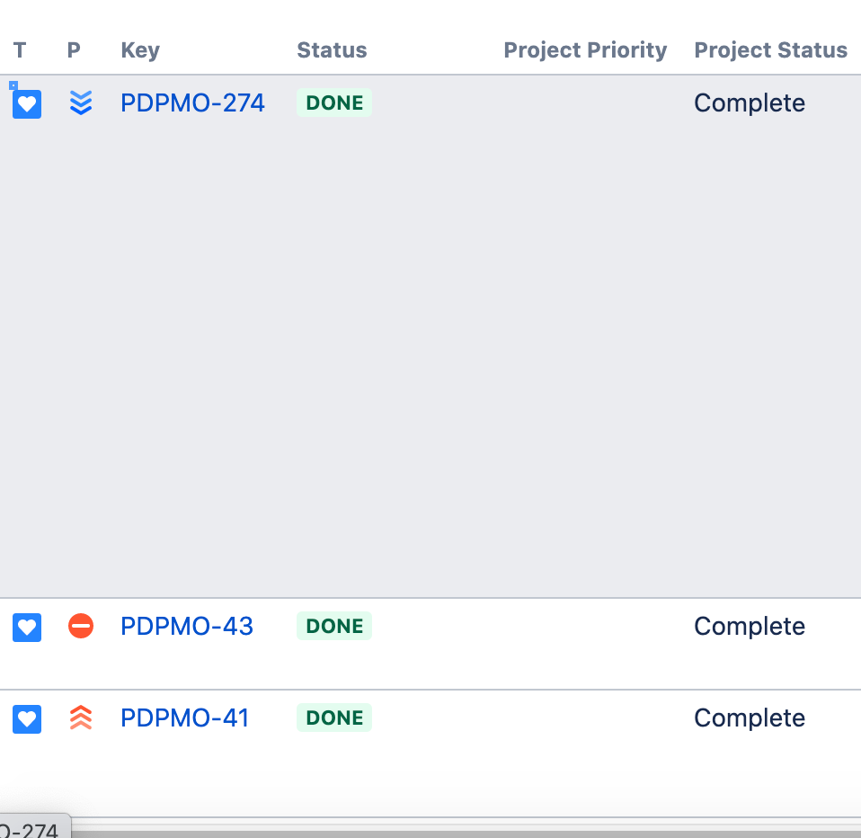

Prexa Patel
May 25, 2021
Prexa Patel
May 25, 2021
@Kristján Geir Mathiesen as you can see in the above screen shot the 6th field is Project status.
