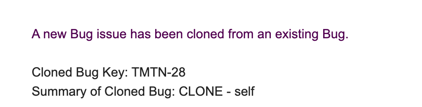

So the send email trigger would have below
A new Bug issue has been cloned from an existing Bug.
Cloned Bug Key: {{issue.key}}
Summary of Cloned Bug: {{issue.summary}}
Please check the new issue for further details.
When there is an existing issue with the type bug, you will get an email which will give you details of the cloned issue. so when you open the cloned issue, it would show from where this issue was cloned

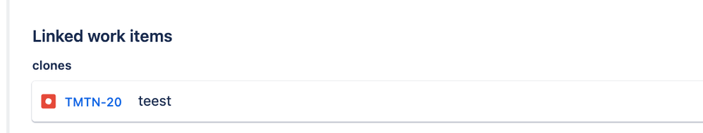

example
YOu can try something on this lines

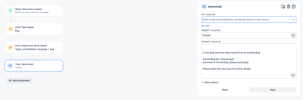

Hey @Francisco Navarro
If the work-item is cloned, then the linked issue will be filled by the original work-item.
So you can create an automation:
1. Trigger = created work-item
2. If issuetype = Bug and Linkeissue type = Clones
3. Action = send email.

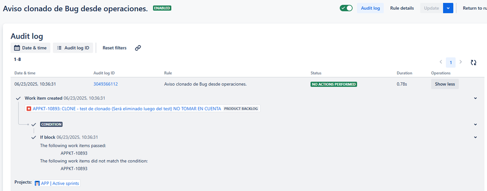

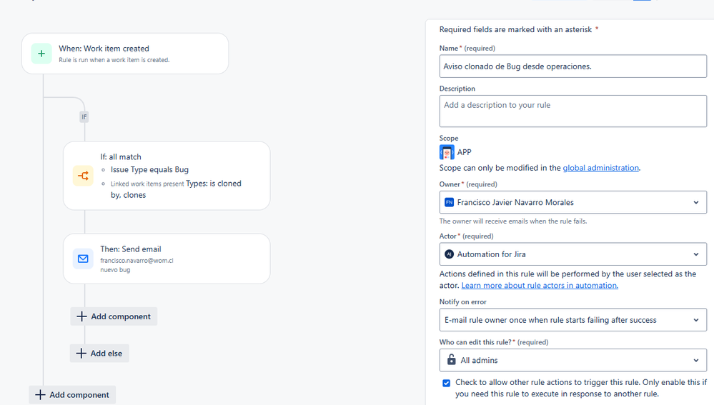

I created another automation with your steps, but it doesn't perform the action. I'm sending you an image of the log. I first performed this test without activating the rule box "Check to allow other rule actions to trigger this rule. Only enable this if you need this rule to execute in response to another rule" and then activated it. In both cases, it did not perform any action.

Okay, modify your rule above to put in a Re-fetch action (or two) after the Create trigger. What is probably happening is that the work item gets created and before the other automation is done to link the tickets, this rule is firing the IF condition. Have it slow down a little in between with the Re-fetch and see if that works. If one doesn't, then try two (or put in a Delay action of 5 seconds or so).
