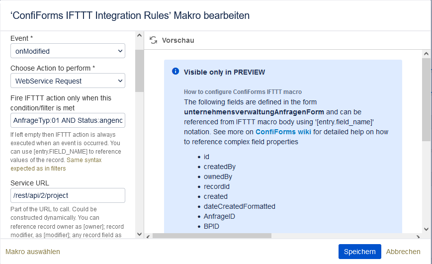

I want to create a project in Jira Server via Confiforms webrequest ifttt
So i did successfully first the connection link between the confluence and jira server.
Case: I created a form and in the form some fields. One field is a status and when a status's value changed and equel "approved" then would create a project in jira.

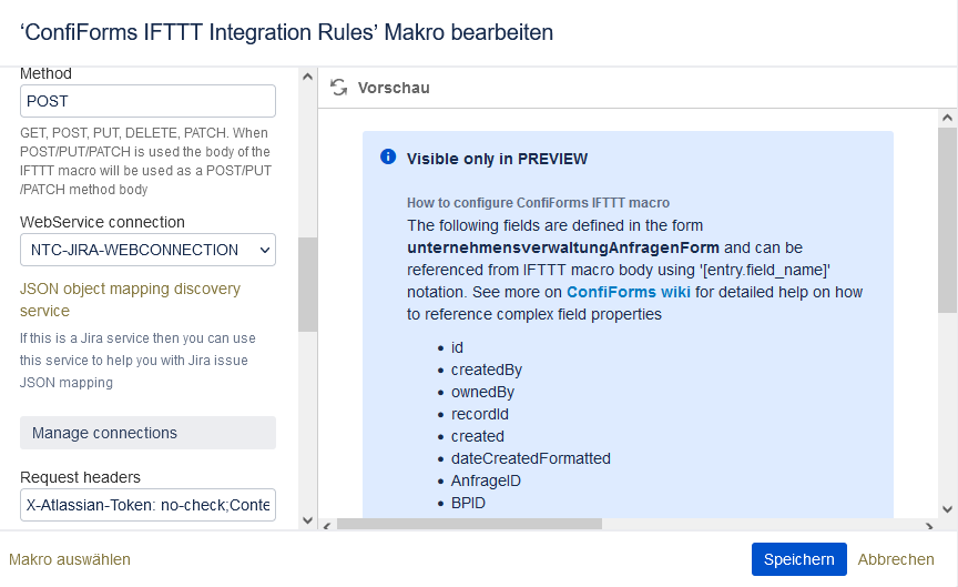

There are the Ifttt macro setting:

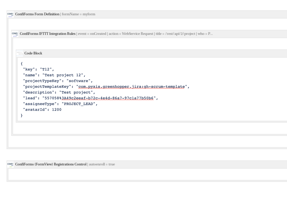

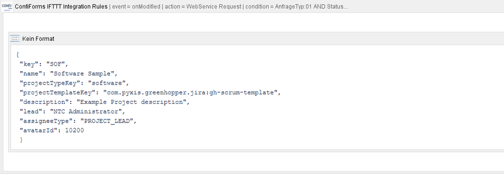

There is the Ifttt macro body

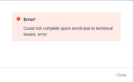

But After the onModified event came the following error:
Could anyone please help me to get this correctly?

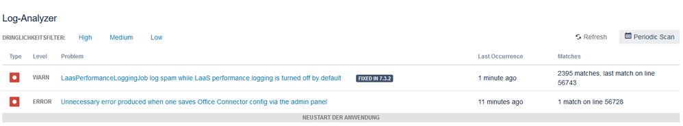

I had looked and found the following:
What that means???

Not sure what this screenshot illustrates, so I cannot comment

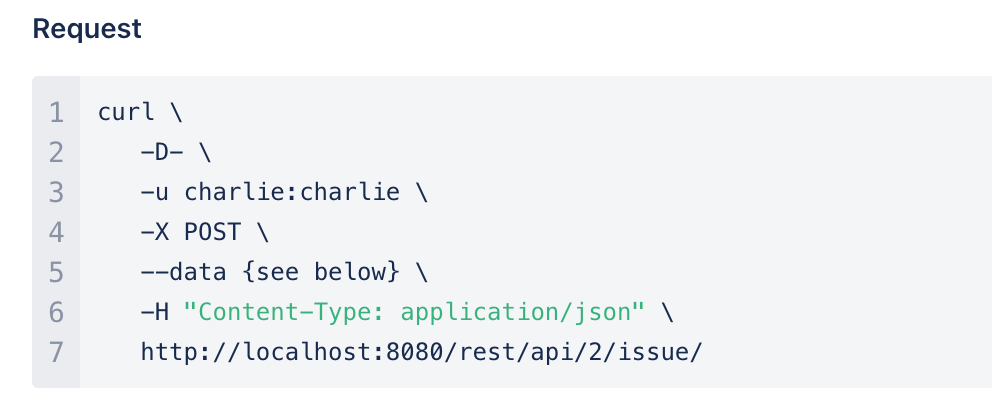

I mean, from the example like
you should be able to produce the one that you need... right? Just posting to a different URL and different JSON... seeing how it's done in example

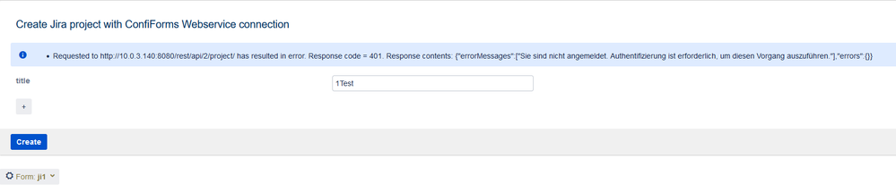

The easiest option to debug your Jira REST API call with ConfiForms is to create a simple form like this
This you can submit and receive a response back (if error), which will help you to identify what is wring with your JSON or WebRequest configuration

The problem was authentication because i had created the web service without authentication!
The connection now is with authentication and it works :)
