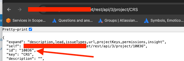

To get the project ID, in a browser tab execute this URL:
https://{yourJiraUrl}/rest/api/3/project/{projectIdOrKey}
For {yourJiraUrl} insert the base URL for your Jira Cloud instance; i.e. abc.atlassian.net.
For {projectIdOrKey} insert the key used by your project. That is the text that proceeds the dash for issue keys in that project; i.e. XYZ-123. The output will include the project ID

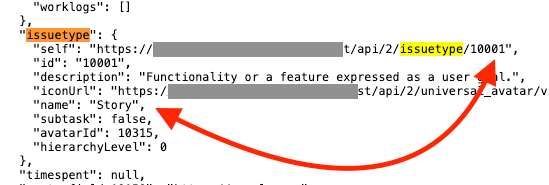

To find the ID for the issue type, first find an issue of the desired type in the destination project.
Then execute this URL in a browser tab:
https://<yourinstanceurl>/rest/api/2/issue/<issuekey>?expand=names
For <yourinstanceurl> insert the base URL for your Jira Cloud instance; i.e. abc.atlassian.net.
For <issuekey> insert the issue key for an issue of the same type from the same project; i.e. XYZ-123.
Search for a section that looks like the one below. Make sure it shows the correct Name for the issue type, and get the corresponding numeric ID for that type.
