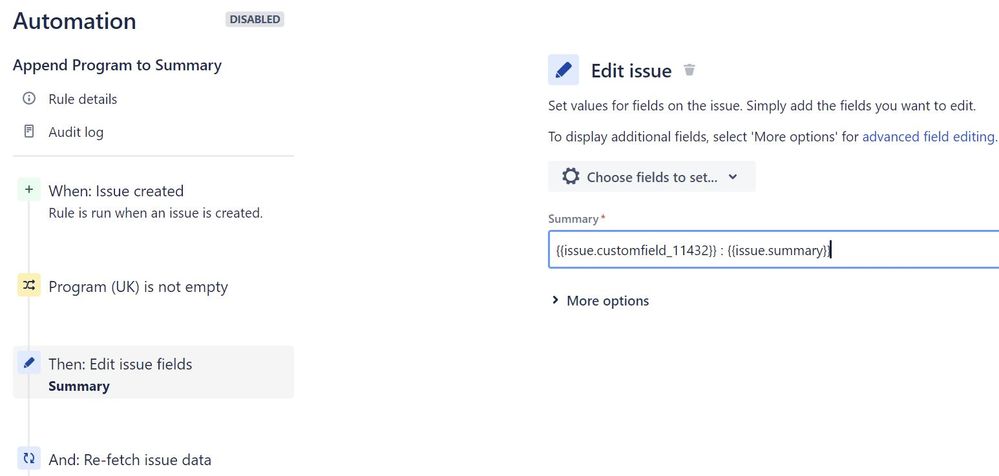

Thanks for your reply. I have included a snip of the rule below, and as you'll see it is pretty simple.
Objective: amend Summary field to be custom field + " : " + Summary.
This is for the benefit of agent users receiving email notification of the new issue being created. The custom field contains a customer code, so adding it makes it obvious from the email Subject field (= the Summary field) alone, who should react first to the new issue.
This will trigger for every new issue created.
The particular custom field is added into the contents of the standard Summary field.
Standard "new issue created" email notification is sent.
The problem is that although all saved info is correct when we look at new issues in Jira, the new-issue-created email notifications show the original, unmodified Summary field in the Subject.
