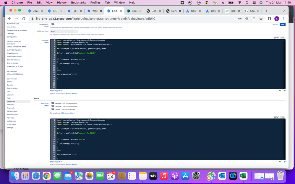

I have tried using behaviour and putting my script in the Initialiser and in the server script as well for the corresponding field but the validation does not seems to work.

Hi Fabio,
I have written the same script in both the places already.
But at the time of Editing the Issue if I change the issue type say from task to Bug then the corresponding "Root cause" field does not become mandatory and vice-versa. Please could you go through the script and let me know the changes .
Hi @shrikant maheshwari ,
Initializer works when you open the edit/create screen.
If you want that your code works when change a specific field you need to add the same script also for that field. In your scenario, you need to put the same code at Issue Type field level
It should fix you issue.

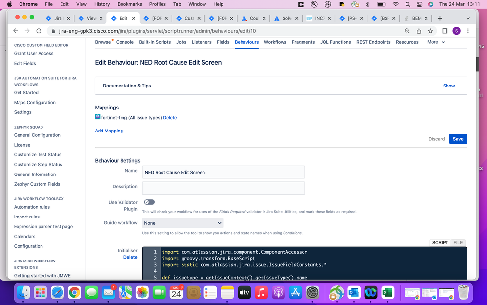

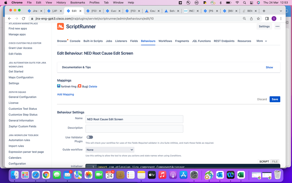

Hi Fabio,
please find the mapping screen shot and the problem is when i am trying to edit an existing Issue and then changing the Issue type to "BUG" then Root cause field is not becoming mandatory its still non mandatory.
that is the problem. You behaviour currently works just for bug. If you need to work for all issue types (mandatory field should depends form all issue types) you need to edit mapping so that it works at project level and for all issue types.

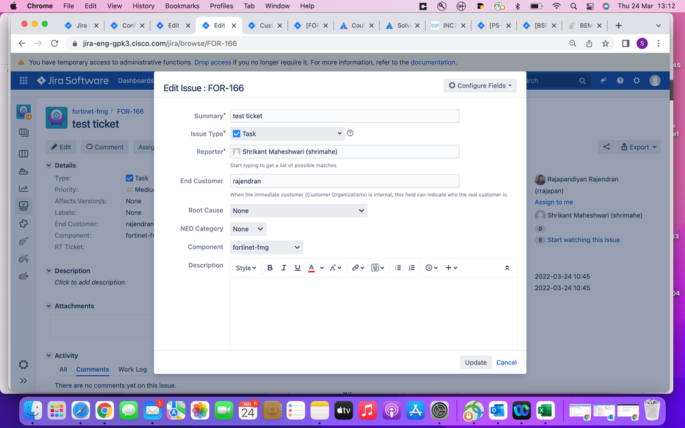

I have already tried that but it does not works, please find the attached screens shots.
Please see the screen shot 2 and 3 , so my original issue was TASK and when i clicked on EDIT and changed the Issue type to BUG still the field root cause is not mandatory.

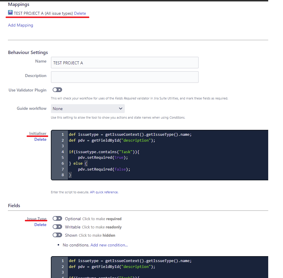

In my local environment it works like a charm. Please verify that your cf id is correct.
If you selected all issue types as mapping and put your code in Initializer and Issue Type, it should work.
