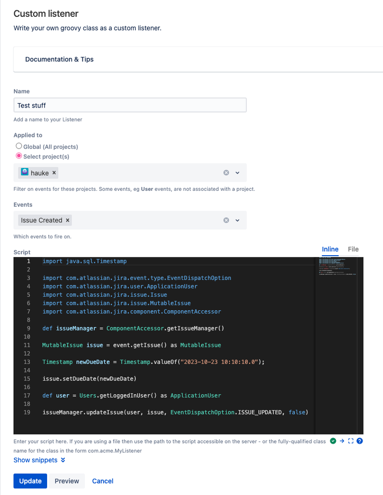

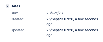

I used the base part of your code to reproduce this, but in our instance (Jira DC 9.9.1) this works:
The actual code:
import java.sql.Timestamp
import com.atlassian.jira.event.type.EventDispatchOption
import com.atlassian.jira.user.ApplicationUser
import com.atlassian.jira.issue.Issue
import com.atlassian.jira.issue.MutableIssue
import com.atlassian.jira.component.ComponentAccessor
def issueManager = ComponentAccessor.getIssueManager()
MutableIssue issue = event.getIssue() as MutableIssue
Timestamp newDueDate = Timestamp.valueOf("2023-10-23 10:10:10.0");
issue.setDueDate(newDueDate)
def user = Users.getLoggedInUser() as ApplicationUser
issueManager.updateIssue(user, issue, EventDispatchOption.ISSUE_UPDATED, false)
Does "the update don't go into the DB" mean, that in your issue view the due date field is incorrect and not set to the value that your listener should set?
Do you see any log lines in atlassian-jira.log about that?
