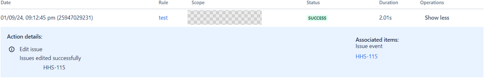

Gal Fatal
January 9, 2024
Hi @Fabian Lim
Thanks.
Nothing special or limitation in the field context. and here is the log.
(I amnaully succeed to update this field on the child)
Field context
