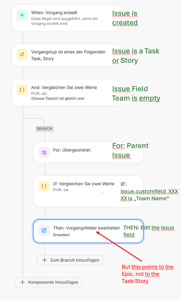

timothy.higgs.extern
November 24, 2025
@Christos Markoulatos -Relational-  thanks for the reply.
The problem I run into when I create a branch to look at the Epic, is that I can't seem to then find a way inside that branch to update the team of the newly created Task/Story. I'm only able to edit the Epic because I'm looking at the Epic.
I'm hoping there is a way to do this and I just don't know it yet, but I haven't found a way yet.
Do you know how to do this?
I've included a screenshot and added translations cuz our Jira instance is in German
Thanks muchly

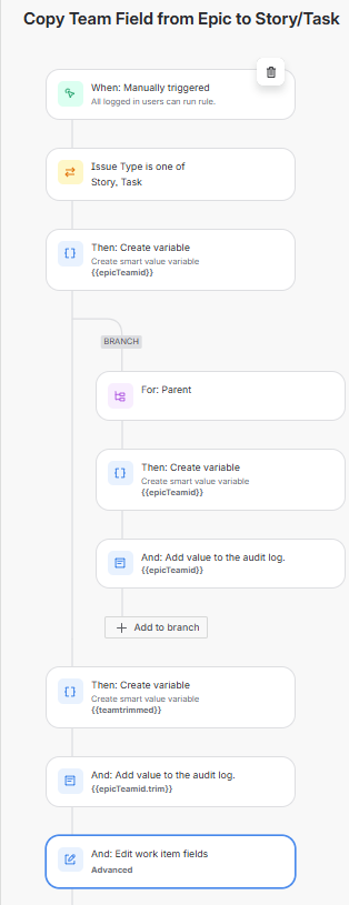

Now this was a weird one but made it work like so
I solved this by creating a Jira Automation rule that copies the Team field from the parent Epic to a Story or Task. The key is variable scope: variables created inside a branch don’t persist outside, so you need to declare the same variable name both inside and outside the branch
  • Trigger
    • Manual trigger (you run it on a Story/Task).
  • Condition
    • Issue type is Story or Task.
  • Create variable (main scope)
    • epicTeamid (initially empty or placeholder).
  • Branch: For Parent (Epic)
    • Inside branch:
      • Create variable epicTeamid = {{issue.customfield_10001.id}} (Epic’s Team ID).
      • Log {{epicTeamid}} (to confirm value).
  • Back to main scope
    • Create variable teamtrimmed = {{epicTeamid.trim}} (removes whitespace).
    • Log {{epicTeamid.trim}} (audit check).
    • Edit issue fields:
    • Json:
      "fields": {
      "customfield_10001":"{{epicTeamid.trim}}"
