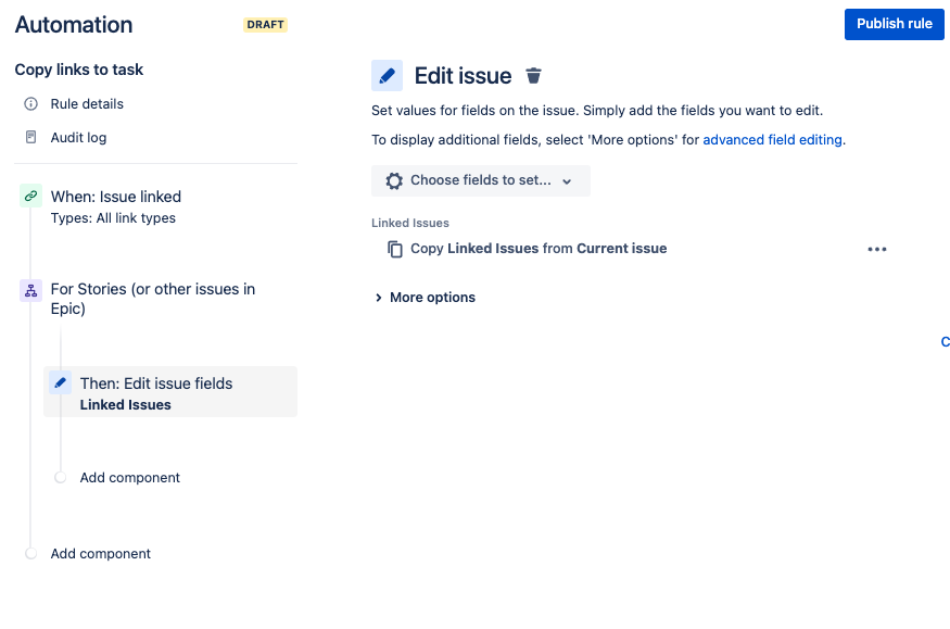

Whenever a user applies a issue link to an Epic, I would like it to apply to all issues in the Epic.
This is the current rule I have that does not work. Based on the audit log, nothing occurs after a link is created.
Bill Sheboy
October 18, 2021
Hi @Brett Fitzpatrick
Does the audit log show the rule triggering?
And, two suggestions to help:
  1. after the trigger add a condition to confirm the issue type is Epic
  2. in your edit issue, change to use Copy From Trigger Issue, rather than current issue.

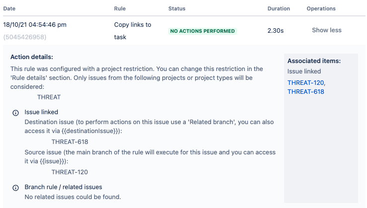

Here is an example from the audit log:
Bill Sheboy
October 18, 2021
Thanks, Brett.  Are you certain that is the correct log, as it does not match the rule image you posted?  For example, there is no indication that the condition did/did not match.
Brett Fitzpatrick
October 18, 2021
I sort of tracked down the root cause. In the above ticket, THREAT-120 is the ticket being linked and THREAT-618 is the Epic. I would like the link of THREAT-120 to be on all the issues in the Epic (Threat-618), thus, I must use the "Destination Issue". Unfortunately, I don't believe I can further loop on the destination issue as I can't create another branch off of it.

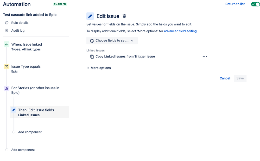

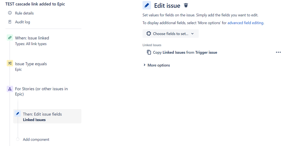

Here is a copy of your rule:
I could be mistaken here but I believe this rule doesn't fire because the issue being linked is an Initiative. I think what I would need to do is loop all the other issues in the smart value object "destinationissue" but I don't believe this is currently possible?

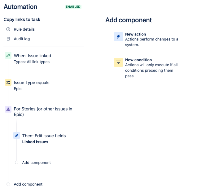

Brett Fitzpatrick
October 18, 2021
Hey @Bill Sheboy !
Thank you so much for your rapid response. Its unfortunately still not adding the links to the tasks under the epic.
Current automation:
