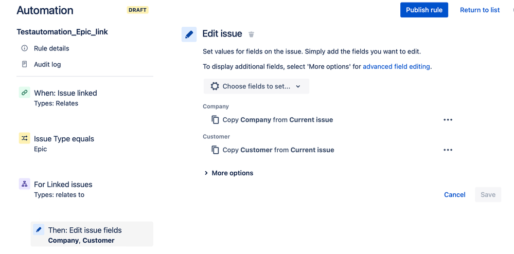

I'm trying to create the following automation rule:
When an Epic is created, the information for the custom fields ("company" or "customer" for example) are filled in. When a task with subtasks is then linked to the epic, I want the automation to copy the information from the custom fields in the epic into the custom fields of the related tasks and subtasks (they have the same custom fields).
I already tried some different rules but none of them worked so far so I would be grateful if somebody could tell me how to change the rule.
Kind regards,
Pauline
John Funk
July 29, 2022
Hi Pauline,
You are close, but click on the words Current Issue in each of your fields, and then change it to Trigger Issue instead of Current Issue.

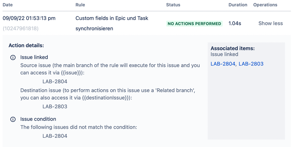

Hi,
my automation suddenly doesn't work anymore and I absolutely don't understand why because I changed nothing on it. Here's what the audit log says:
Do you have an idea what could be the reason for it?
Kind regards,
Pauline
John Funk
September 9, 2022
Can you post the rule as it exists now  - maybe showing the expanded Condition that is failing?

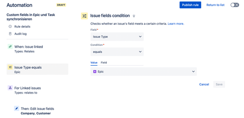

Pauline Hild
September 10, 2022
Yes, for sure. You'll find the screenshots down below.

John Funk
September 12, 2022
No, what is the key for the Epic? LAB-2804 or LAB-2803?
Pauline Hild
September 12, 2022
Sorry! LAB-2804 is the Task
John Funk
September 12, 2022
Thought so - that's the problem. You have a condition that is checking to see if it is an Epic. 2804 is not, so the rule execution stops there. If you reverse the order, it might work.

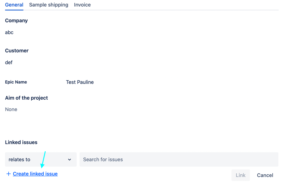

Pauline Hild
September 14, 2022
I just found out that the automation works when I link an issue by clicking "+ create linked issue" but when I use the "search for issues" function to link an issue, it doesn't work. Do you know why this is the case?
John Funk
September 14, 2022
Well, that's just weird. It should process the same way, I would think. Maybe it considers one to be the source and the other to be the destination based on which one you choose. Seems like a bug of inconsistency. I would actually report that to Atlassian.
