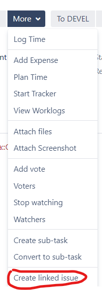

Hello @Ram Kumar Aravindakshan _Adaptavist_ , thank you for answering. I'm not sure whether it's a transition screen, but I can create a linked issue on my issue page this way:
Snímka obrazovky 2023-07-07 130413.pngf

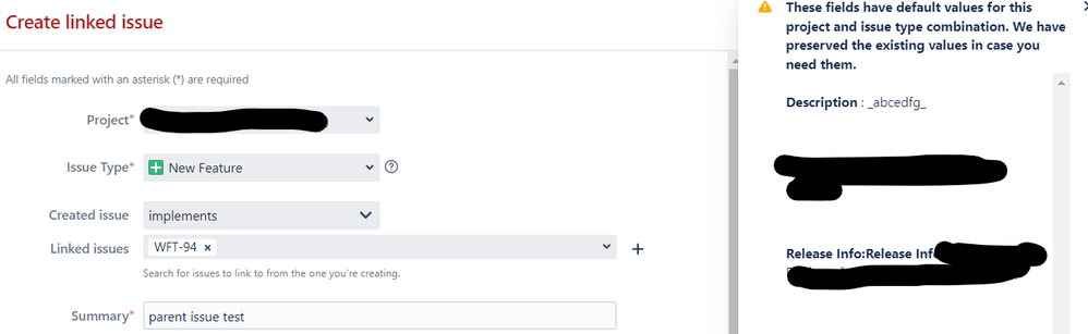

which then brings this Create Linked Issue Screen popupSnímka obrazovky 2023-07-07 130650.png
It even has the popup on the right which has the existing description saved so I'm wondering if it's possible to just copy the existing values right away and not have it done manually.
