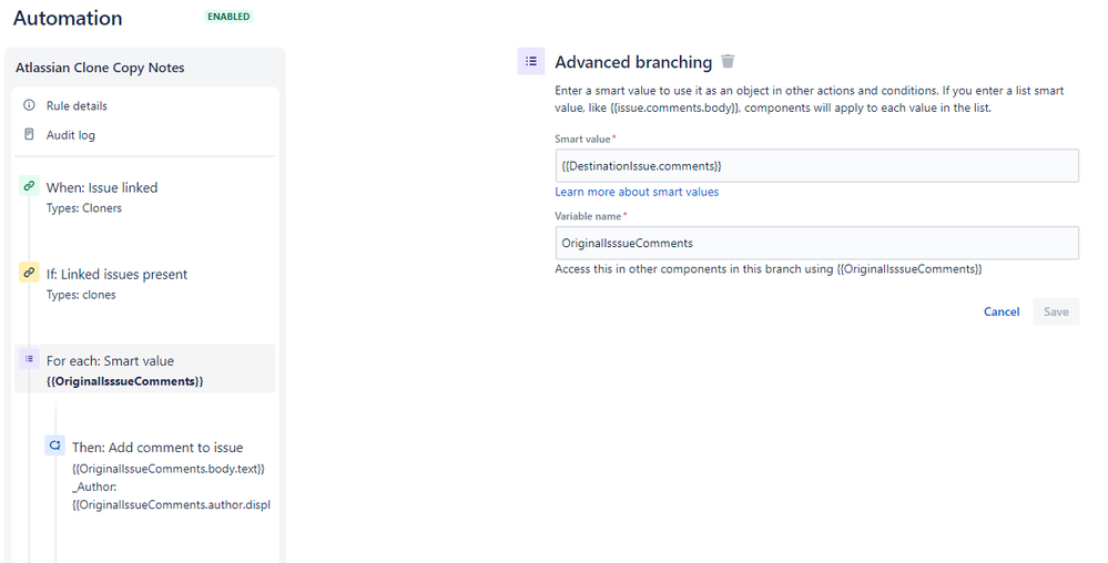

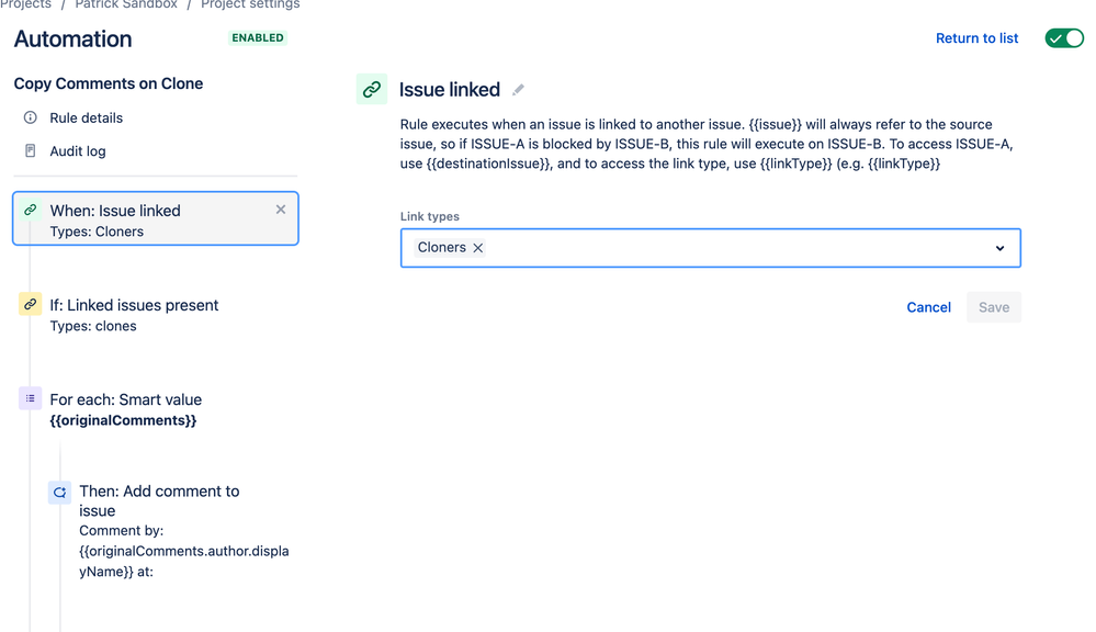

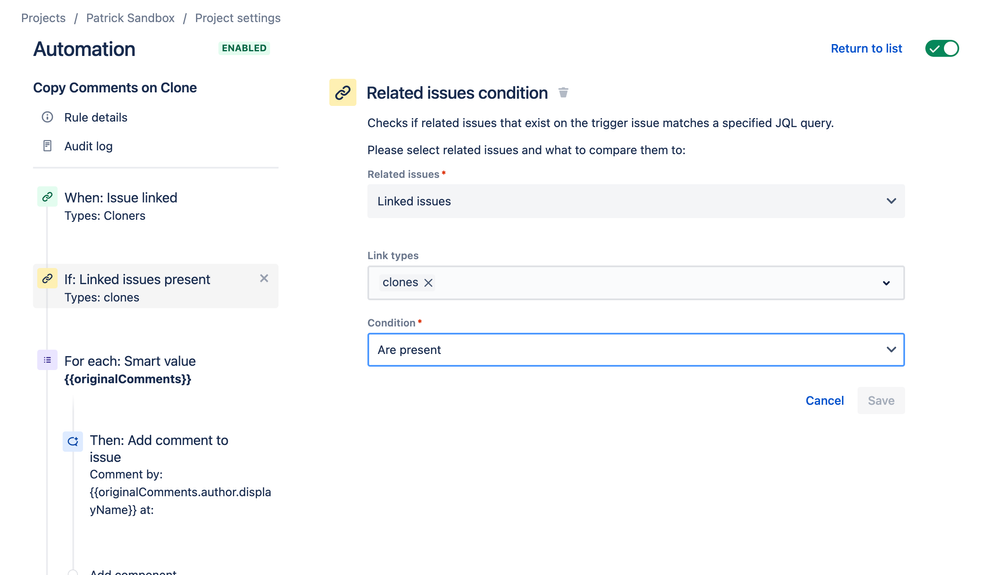

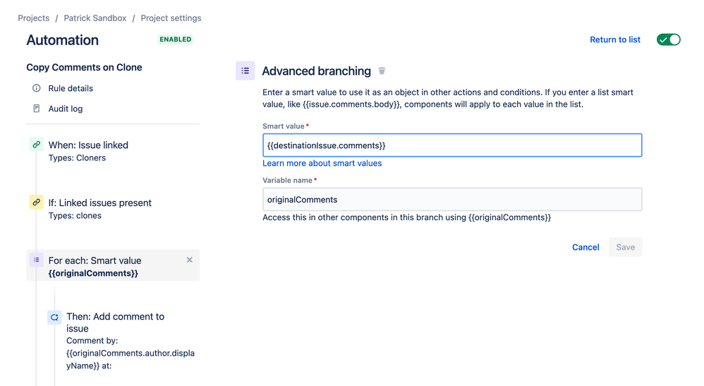

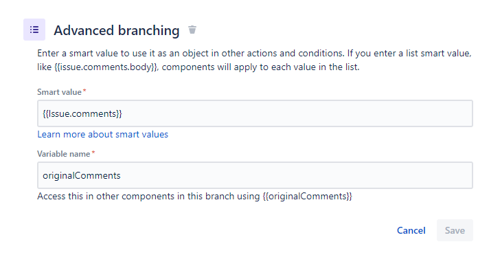

You can create an automation that is triggered on issue link > then look for {{destinationIssue.comments}} (this looks for the issue that yours is cloned from) > use an advanced branch to iterate over each comment and >  then add the comments one-by-one to the cloned issue.
I used these articles to help me get here:
https://support.atlassian.com/cloud-automation/docs/jira-smart-values-issues/
https://community.atlassian.com/t5/Automation-articles/Branching-over-smart-values-in-Jira-Automation/ba-p/1741935
Screen Shot 2022-11-01 at 4.13.19 PM.pngScreen Shot 2022-11-01 at 4.13.30 PM.png
Gary Spross
November 17, 2022
The branching shown in this example collects the comments from the destination issue and then adds those comments to the destination issue.
How would you copy the comments from the source issue to the destination issue?
Patrick Seamars
November 17, 2022
I believe the naming of that is counter-intuitive. It actually takes from the source issue and copies to the new, cloned, issue. It confused me as well, but it does what I want it to.

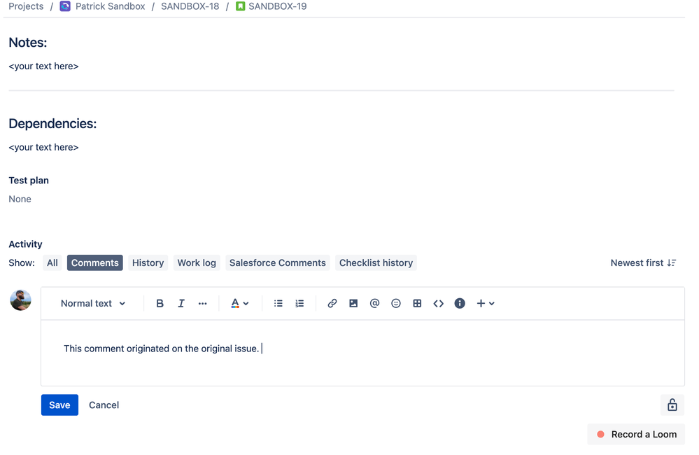

I believe the destination issue in this case is the original issue that was being cloned from because the issue triggering the automation is the cloned issue.

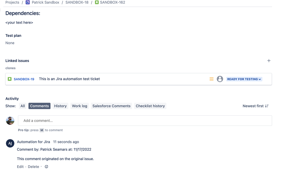

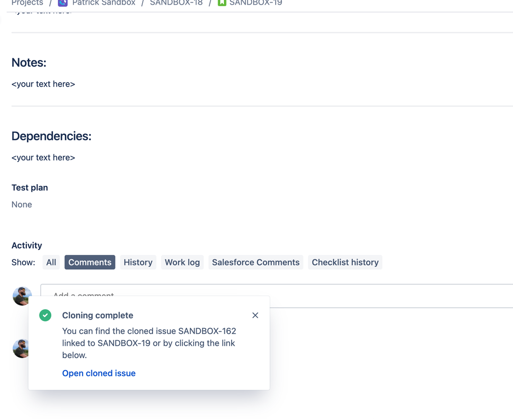

I just ran through the use case again to check my own sanity and it's working as I understand you're expecting it to.
Add comment to original issue:
Clone issue:
Look at Cloned issue and see the magic:

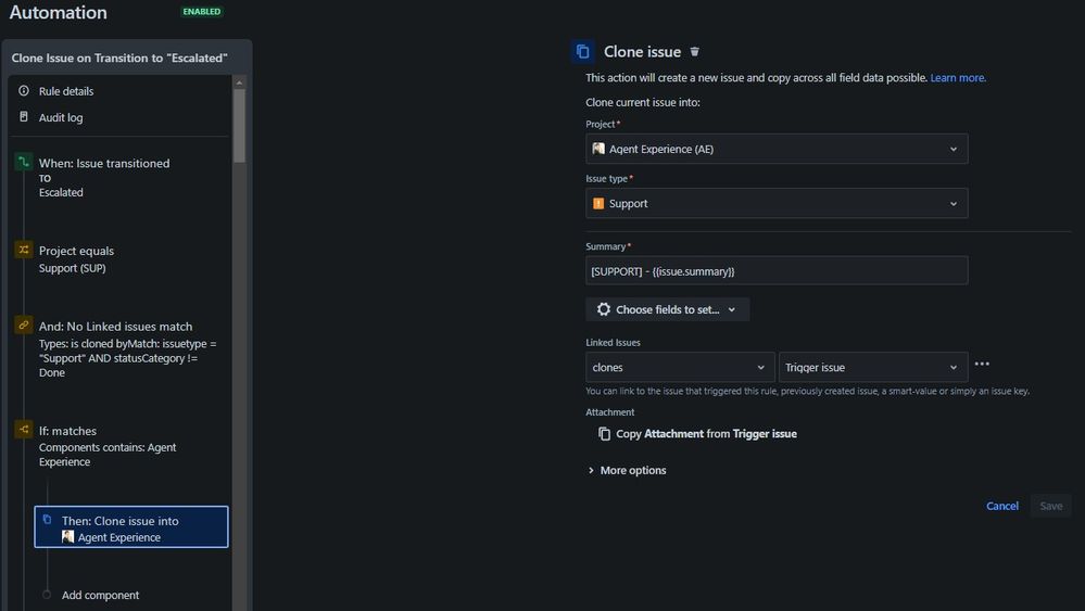

The cloning I'm doing is occurring within another automation rule, based on the transition of the issue.
Within the automation rule to copy the comments, the source issue is the original issue (SUP) and the destination issue is the cloned issue (AE).
So, that seems to be my problem, because when adding the comment, the logic wants to do it against the source issue. I have no way to tell it to add the comment to the destination issue.
If I could either flip the issue scope of the rule or add the comment to a specific issue, then it would probably work.

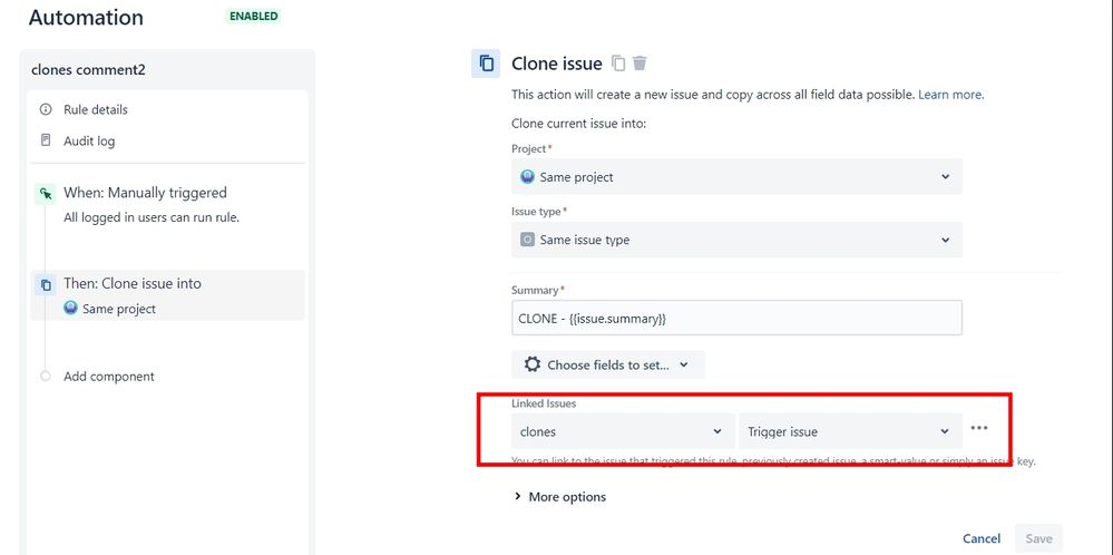

Yeah, that is the problem. I just confirmed it by cloning an issue manually. When cloned manually, the source issue is the newly cloned issue and the destination issue is the issue that was cloned from. When cloning occurs from within my automation rule, the subsequent automation rule gets the issues reversed.
I looked into my automation rule that is cloning the issues and I set up the link type backwards... Corrected this and now it's working as expected.

I am cloning the issues through automation. Within the action to clone the issue, I was setting the link type to "is cloned by". However, when an issue is cloned within Jira, the cloned issue is linked to the other with the "clones" link type. I had to switch the link type to "clones" in my automation rule action so that the other automation (to clone comments) would work properly.

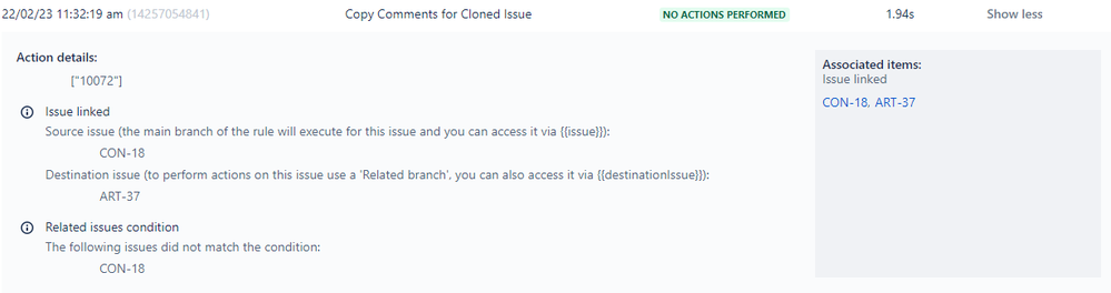

I think this entire thing is great however i cannot get it to work either.  i am also triggering the automation from another automation and i cannot get the rule past the following.
doesnt matter if i use clones or cloned by
CON-18 clones ART-37
ART-37 is cloned by CON-18
suggestions?

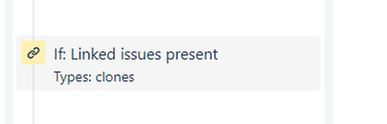

Gary Spross
February 22, 2023
@Wally Brabec

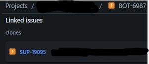

Your issues "CON-18" links to "ART-37" using the "clones" link type?
Like this:
Can you send a screen capture showing the link on "CON-18"?
Based on the automation audit log message of: "The following issues did not match the condition: CON-18", it doesn't seem like the automation rule is seeing this as the case.

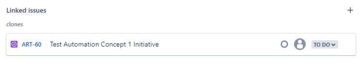

Wally Brabec
February 23, 2023
doing lots of testing so ART-37 have changed to ART-60 (2nd image).  got through some of my issues however the largest issue is what i think others are experienceing.  i need to take all the comments from CON-18 and populate ART-## however the process always goes to CON-18 for the update.  i did get the rule to fire using "clones".  if i use the smart value of {{Issue.comment}} then CON-18 duplicates all comments.  if I use a smart value of {{destinationIssue.comments}} nothing updates.  To reitterate what i said above i cant figure out a way to update ART-## with all the comments from CON-18 (i am using the workaround suggested by Jesse and even thought it works i would prefer to have each comment separate instead of in one large comment.
Thanks for any help in advance

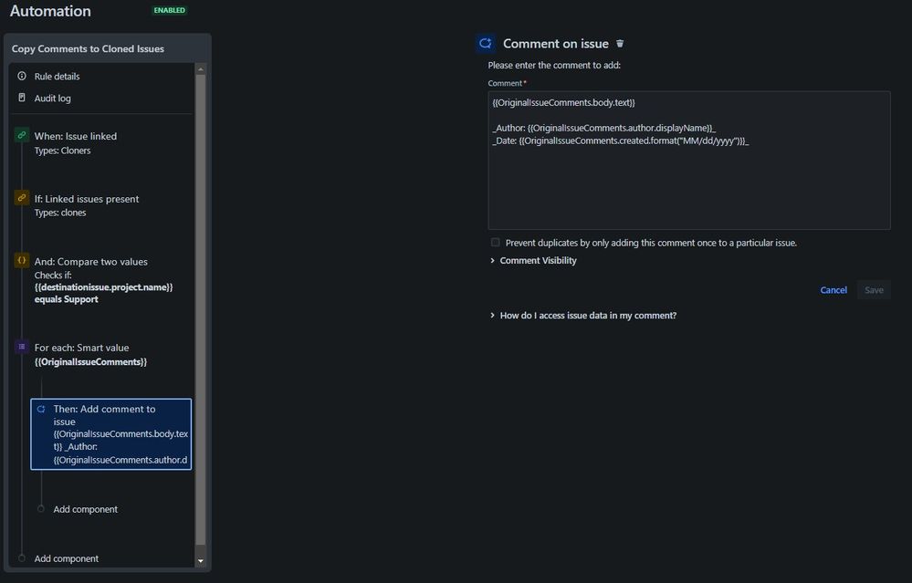

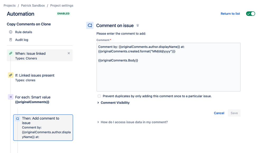

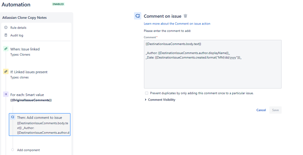

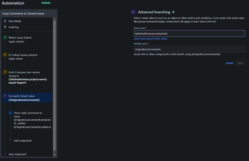

Let's try this...
Here's screenshots of my 2 automation rules.
This is the automation that clones the issue. You can see the clone type being used is "clones" and it points to the issue that triggered the automation rule to run.
These screenshots are each step of the automation that copies the comments to the issue that was cloned.
Note: The "Check to allow other rule actions to trigger this rule. Only enable this if you need this rule to execute in response to another rule." checkbox is checked.
Rule triggers when a link type of "cloners" is established.
A check ensures that the issue this rule is running against has a link to an issue using the "clones" link type.
A branch rule is added to cycle through the comments from the "destination" issue.
The add comment action adds each comment from the "destination" issue to the "trigger" issue (with some additional data for clarity).
Hopefully this helps you to compare the configuration of your automation rules.

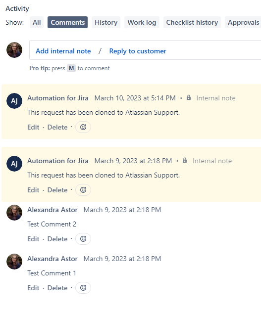

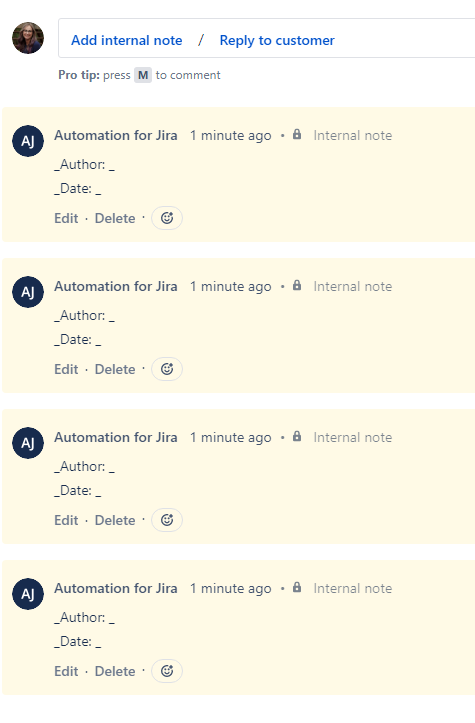

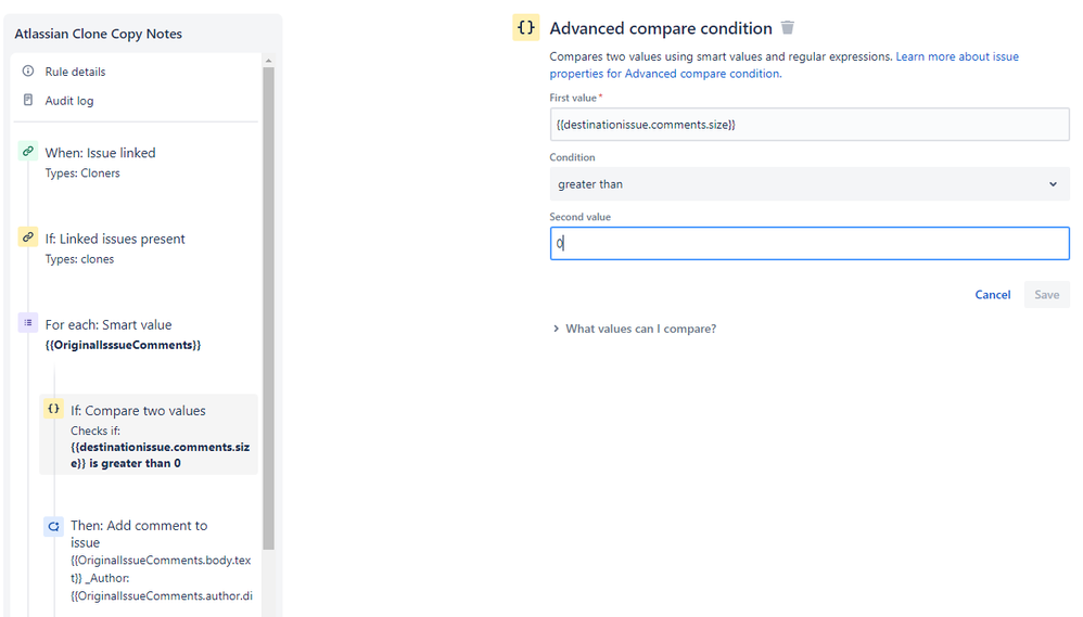

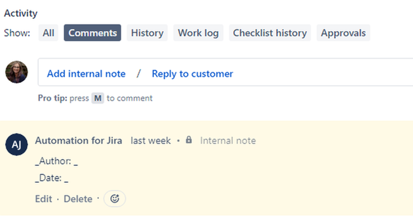

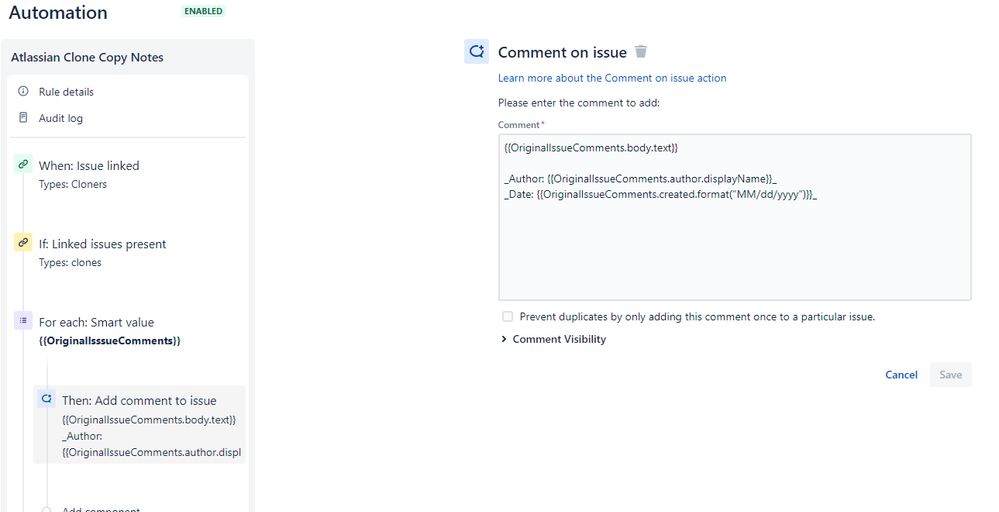

Hi!  I am having the strangest issue.  I was able to follow the steps above and a comment is now populating in the cloned issue.  However, the smart vales aren't pulling over the comment.
Gary Spross
March 13, 2023
@Alexandra Astor, I'm not sure what you are saying your issue is. You said the comment is populating in the cloned issue, but the smart values aren't pulling over the comment. What do you mean by "the smart values aren't pulling over the comment"?
Alexandra Astor
March 17, 2023
Hi Gary - The automation is creating a comment in the cloned issue but it only has the static text from the automation rule.  It is not pulling in anything from the smart values.  Here are some screenshots:
Gary Spross
March 17, 2023
Your named the smart value: OriginalIssueComments, but then, when adding the comment, you referenced the smart value as: DestinationIssueComments. Change the smart value reference to OriginalIssueComments and it should work.
Alexandra Astor
March 17, 2023
Still no luck unfortunately.
Gary Spross
March 17, 2023
Send a screen capture of the component that is creating the smart value. I'm guessing the smart value you're specifying is incorrect. It should be: "{{destinationissue.comments}}".
Alexandra Astor
March 20, 2023
Here it is:Capture.PNG
Gary Spross
March 20, 2023

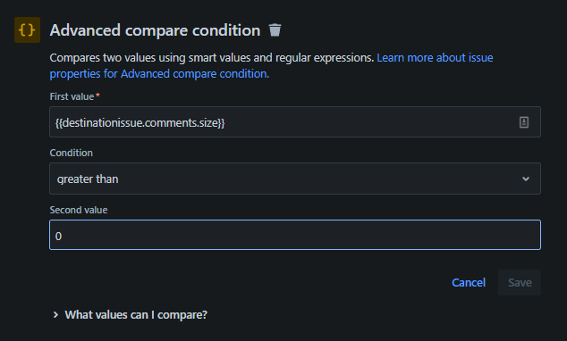

Dumb question... Are there comments to copy from the issue?
You can add a log showing the # of comments:
# of comments: {{destinationissue.comments.size}}
I added a check in my rule to only proceed if there are comments to copy.
If there are comments, then maybe try adding a log to just capture the comments to see if it's something to do with the smart value you're specifying.

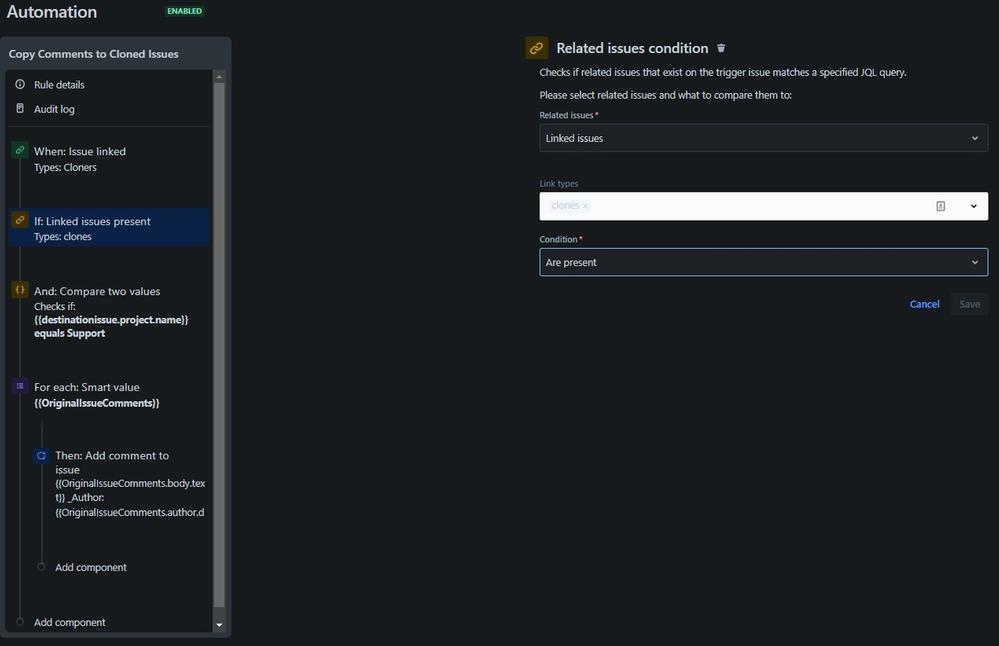

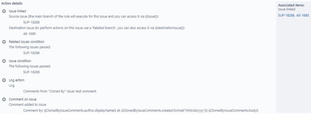

Alexandra Astor
March 20, 2023

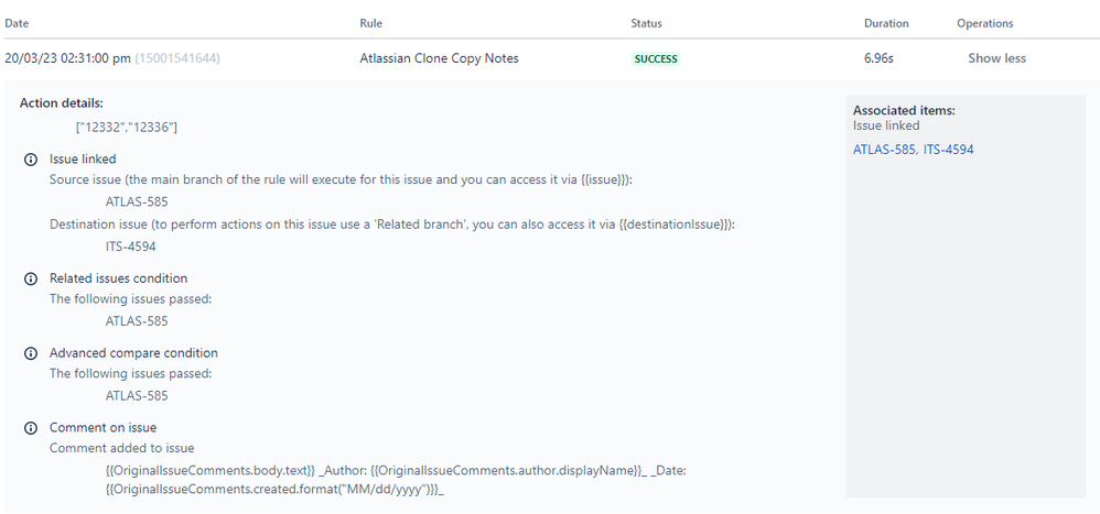

I haven't used this type of condition for automation before.  I think I added it correctly?
Here's the audit log:
Any chance that helps?
Alexandra Astor
March 20, 2023
oh and to answer your question, yes there are comments.  Not a dumb question, I've double checked several times.
Gary Spross
March 20, 2023
  1. The "Advanced Compare" action should be prior to the "Smart Values" branch.
  2. I don't see anything wrong with the configuration of your rule, so the only thing I can think is that the link is backwards.
    1. Which ticket has the comments you want to copy?
    2. Based on the audit log, you are attempting to copy the comments from the ITS ticket to the ATLAS ticket
    3. Is this correct?
    4. If it's supposed to be the other way around, as a test, update the "If: Linked issues present" condition to "is cloned by" and see if that works
    5. If this works now, then change this rule back and in your other automation, to clone the issue, change the link type being applied to "clones" instead of "is cloned by"

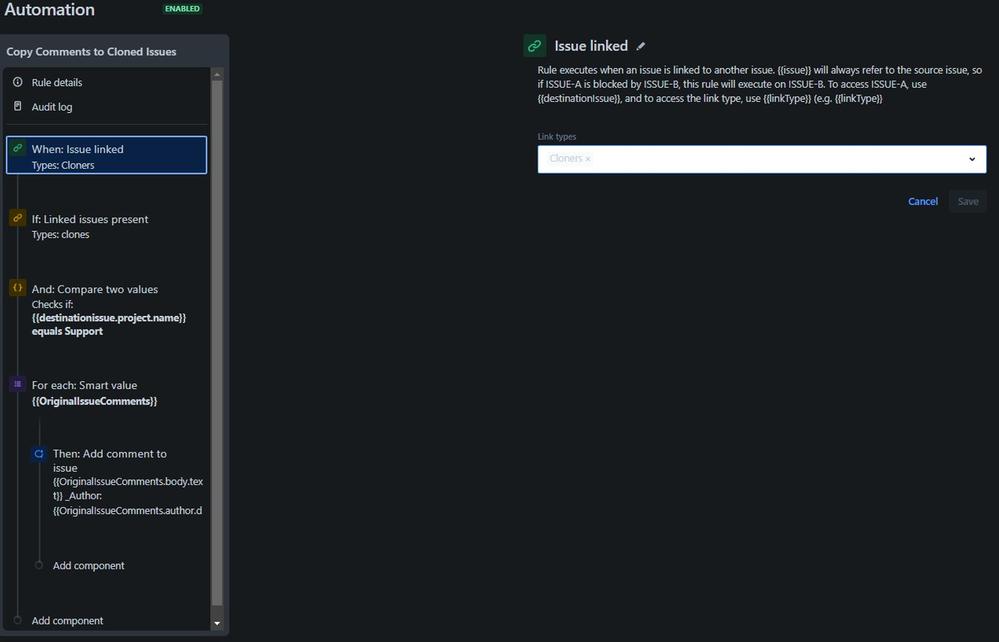

Isaac Savage
December 11, 2023
@Gary Spross Thanks for sharing those screenshots. The "Global" adjustment fixed me right up.

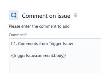

Jesse Kona
March 31, 2022

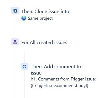

As a workaround, you can create a comment that has all of the comments from the triggering issue concatenated.  In the automation, after cloning the issue, create a branch to update all created issues, then add a step to create a comment.
Use the smart-value:   {{triggerIssue.comment.body}}

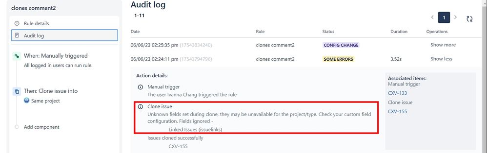

Ivanna
June 5, 2023
Hi @Gary Spross  ,
I don't know why can't the cloned issue be linked, my automation is failed.
