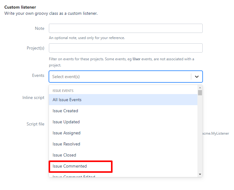

Fran Garcia
October 3, 2019
Don't understand exactly the problem, if you choose custom listener there is an issue commented event that will launch your script.

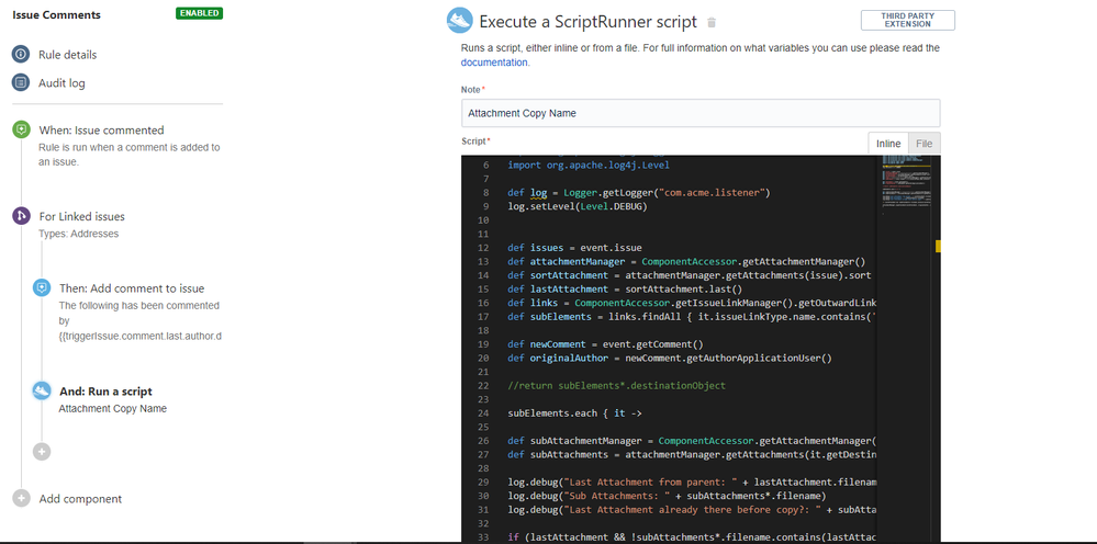

Amit Shaw
September 28, 2023
Hi Ravi,
I am using your above formula bet still getting the error.
I am using the script in automation and want that when ever any comments has been added in the ticket it will check if that attachment has been already there or not. if not then only it will attach it in the linked issues ticket.
Please help me resolve this.

import com.atlassian.jira.component.ComponentAccessor
import com.atlassian.jira.issue.link.IssueLink
import com.atlassian.jira.issue.comments.Comment
import com.atlassian.jira.issue.comments.CommentManager
import org.apache.log4j.Logger
import org.apache.log4j.Level
def log = Logger.getLogger("com.acme.listener")
log.setLevel(Level.DEBUG)
def issue = event.issue
def attachmentManager = ComponentAccessor.getAttachmentManager()
def sortAttachment = attachmentManager.getAttachments(issue).sort { it.created }
def lastAttachment = sortAttachment.last()
def links = ComponentAccessor.getIssueLinkManager().getOutwardLinks(issue.getId())
def subElements = links.findAll { it.issueLinkType.name.contains('Parent/Child') }
def newComment = event.getComment()
def originalAuthor = newComment.getAuthorApplicationUser()
//return subElements*.destinationObject
subElements.each { it ->
def subAttachmentManager = ComponentAccessor.getAttachmentManager()
def subAttachments = attachmentManager.getAttachments(it.getDestinationObject())
log.debug("Last Attachment from parent: " + lastAttachment.filename)
log.debug("Sub Attachments: " + subAttachments*.filename)
log.debug("Last Attachment already there before copy?: " + subAttachments*.filename.contains(lastAttachment.filename))
if (lastAttachment && !subAttachments*.filename.contains(lastAttachment.filename)) {
attachmentManager.copyAttachment(lastAttachment, originalAuthor, it.getDestinationObject().key )
You were quite close in your code but you were looking at the last attachment in your linked issue whereas you have to look into all the attachments. Also you have to search based on the file name using subAttachments*.filename.
I hope it is clear now.
Have a nice day.
Ravi
