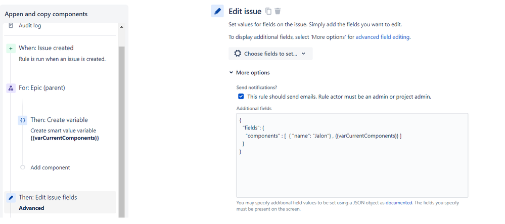

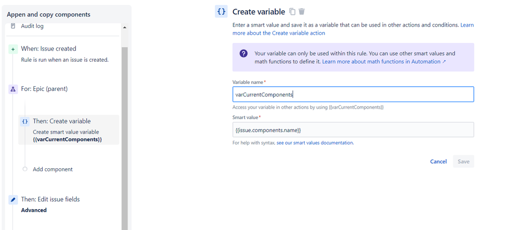

I have been trying to copy components from Epic and add components upon story creation from a manually triggered automation.
I inspired my thinking from this tread : https://community.atlassian.com/t5/Jira-Software-questions/In-Jira-Automation-how-do-I-add-to-a-component-and-not-clear-the/qaq-p/2194124
I feel I am over thinking this, as this can be done with labels on cloud, and if i remember properly, can also be done natively on server.
I feel this is a super normal and common use case, if anyone could point me in the right direction, it would be greatly appreciated.

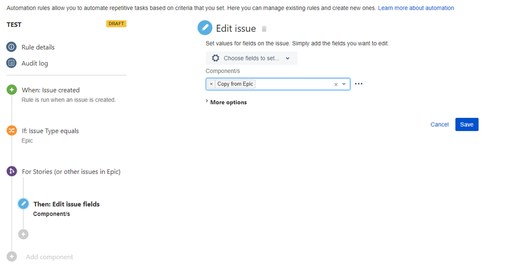

Hi, @MB

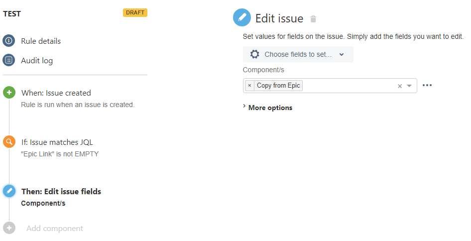

You overcomplicated rule process. You just need to edit issue in rule, and set field component with value, copyied from trigger issue
Evgenii
June 9, 2023
Oh, sorry, I missed, that rule is triggerd by issue in Epic. Then rule is more simpler:

Ok, let's describe it in steps:
  1. You have Epic (without Component)
  2. User manually triggers creation of Stories in Epic
  3. On Story creation you want to set by rule Component in Epic
  4. Then set component in Story
Is it right?

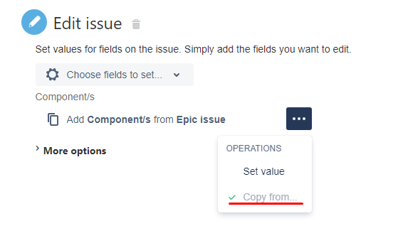

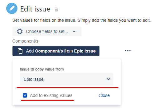

Understood. Then split process of setting Components in two steps.
And while setting of components from Epic use another type of setting field value. "Add to existing values"
MB
June 9, 2023
yeah, I understand this.  But since the rule is created automatically, it will add to a blank field, and in this case, "copy from" would be enough.

In my create issue automation, I cannot add and update the component field at the same time.  I tried copy from epic and in the more section, add a JSON and use an "ADD script" to add the required component.

Evgenii

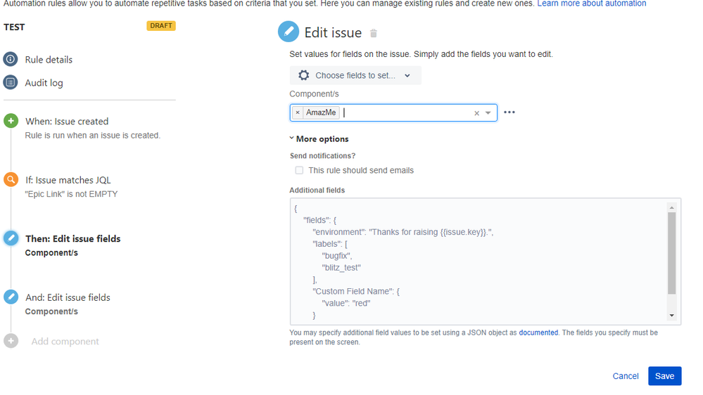

June 9, 2023
On my last screen with rule process - third step makes right what you want. It sets component to story not from Epic. Then, next step - adds Component from Epic.
Component for Stories, that you want to set (not from Epic), is fixed, or it can be different?
If component fixed, then my process should make what you want

Hi Evgeniy,
It is not working because my condition can only be based on the summary, and I am not a fan of having a JQL search run on every create trigger.  I also Create 6 issues off my manual rule, so, making I rule per issue trigger is fugly.
I was thinking of adding a JSON in the "more option" of my create issues manual trigger but I cannot seem to have this work either.
