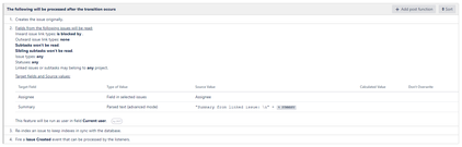

since you want to read field values from a linked issue, you might want to use our post function Read fields from linked issues or sub-tasks. In your case you then only have to select the link type you want to get the issue by (in your case "is blocked by").
The other thing you might want to check is that this post function is positioned after the "Create issue originally" post function.
So the final result of your create transition could look something like this:
Please let me know, if this configuration works for you and if you need further help there ;)

Thanks for your fast answer. Meanwhile I found my Problem.
The issue linking was done after the issue creation. I saw this in the issue history.
So i think in the post function, when i tried to get the linked issues, there were no linked issues yet.
I tried my configuration with an other status transition, there it worked flawless.
