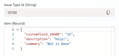

Try using this JSON format for your `item` (adding the "fields" property), it's what ended up working for me.
"fields": {
"summary": "Your Jira Ticket Title",
"description": "Your ticket contents",
It worked for me thanks when I put in the description of the tool:
"fields": {

Add the required Jira fields directly in the JSON body of the Create a new issue (V3) action.
Copilot does not map fields one-by-one. You must pass them manually using field IDs.
Example for Security Level = Internal:
"fields": {
"security": { "id": "xxxxx" }
For custom fields:
"customfield_12345": "value"
Use field IDs instead of names and give defaults where needed.
Once all mandatory fields are included in the JSON, the issue will create successfully.

Any update here I have the same issue I try to pass
"summary": "Your summary here",
"description": "Your description here"
}as item but I get the same errors as above
