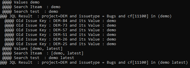

The current script returns the JQL result in the below format ..because of the square bracket the JQL is failing.
So i wanted to replace square bracket with an empty string in JQL

Yogesh Mude
October 31, 2019
checked but not getting field values itself
I tried below...but now I need to add a comma (,) in between two labels..
for (int i = 0; i < lList.size(); i++)
String test = lList.get(i).toString().replaceAll("\\p{P}","")
System.out.println(" @@@@ Search Iteam : " + lList.get(i))
System.out.println(" @@@@ Search test : " + test)
