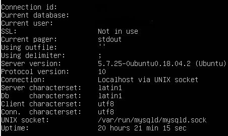

i have fixed the issue by after checking SSL is turned off on my db server and resetting the dbconfig.xml by deleting it and restarting jira to go through with the setup wizard again. Thank you.

Can you share some screenshot of the DB Configuration Screen Page ?
Hiu Hang
December 4, 2019
