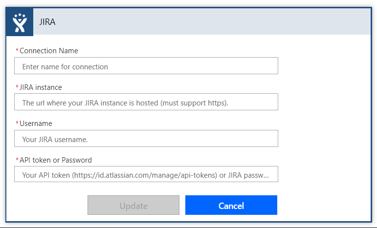

I want to use Microsoft Flow to create a Jira issue from a Microsoft Form submission.
To set this up I need to add a couple of things including the URL of my Jira instance. I've tried the URL that I use to access Jira at work, but the connection fails.
So what then is the URL of our Jira instance? Is there another URL for the Jira instance that is only known to admins?
The Jira version I'm using is server 7.11.
3 answers
Nic Brough -Adaptavist-
March 15, 2019
No, the url it is asking for is the url you visit in your browser.  Can you reach the url you use at work in a browser?
Philip Kanter
March 18, 2019
Thanks for the response Nic!
Yes, our Jira instance is accessible in the browser,  but the URL is strange as it's in this format alpha:1234.
I've tried inputting this but haven't had any success.
March 18, 2019
That's a url with a port specified on the end of it.  That should not be a problem.  Is the system running https?  What is the error you are seeing when the connection fails?
Philip Kanter
March 19, 2019
I'm getting the error message 'Please check your account info and/or permissions and try again'. One thing I've noticed is the URL is http:// which I imagine is an issue.
March 19, 2019
Yes, you must be running Jira on https, as it says in the warning message in your screenshot.

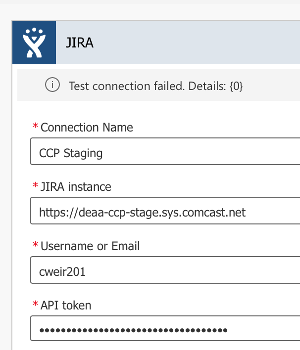

KartikA
August 25, 2020
@Roma Bubyakin _Wombats Corp_
We are using API Tokens for Jira and using API token to make the connection from MS flows to Jira and facing this error. Can you please help.
