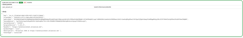

So I have been playing around with this and have enabled the follow in my app descriptor:
"apiMigrations": {
"gdpr": true
When I test using the connect-inspector the /installed event has the payload show below. Notice the user_account_id in the query parameter. This value is not provided for my apps /installed  event. Is this supposed to happen?
I know the user_account_id is in the jwt token under sub but I want to make sure that I am not missing something cause it would be easier to get it from the query parameters.
