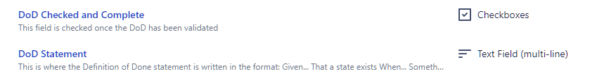

I have created 2 Custom Fields by going to the cog in the top right of the screen then Issues then Custom Fields - It says the fields are created - See image.

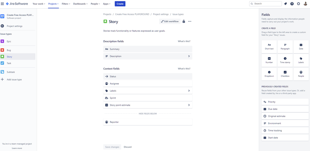

I now go to my backlog and from the left menu I choose Project Settings then Issue Types and select an issue type
My expectation was that I would be able to select the fields I had previously created and add them to each of the issue types in the list BUT... I can't see them on the right hand side of the screen (or anywhere else) to select them?
I know that I could create these Custom fields in each of the Issue types individually but that seems wasteful to me... It would seem better to create them once and then use them in multiple issue types?

The project that you are sharing in your screenshot is a team managed project. Team managed projects are controlled at the project level. So if you would like to create a custom field you would do it on the issue screen that you shared. Team managed projects are self-contained and do not share fields with other projects. More information here: https://support.atlassian.com/jira-software-cloud/docs/customize-an-issues-fields-in-team-managed-projects/
