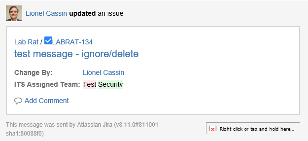

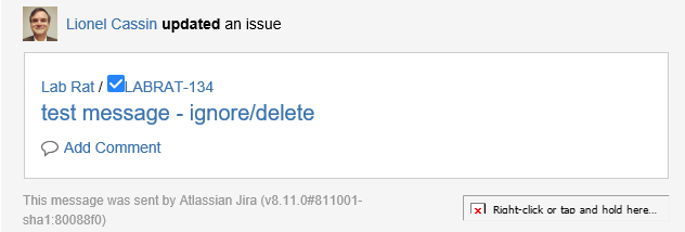

  2. BUT the email does not show which fields were changed and the old/new values: bad update.png
  3. In contrast, this is what a "normal" update notification looks like and what I want mine to look like:good update.png
I think my mistake is in the construction of the issueEvent/eventBundle (below).  I think there should be some way to pass the change log to the constructor, but I just can't figure it out.  Thanks.
