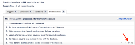

This would be the steps:
  1. Select the Jira icon (, or ) > Jira settings > Issues.
  2. Click Workflows and then Edit next to the relevant workflow.
  3. Select a workflow transition and click Post Functions.
  4. Find the post function "Fire a Generic Event event that can be processed by the listenersand click on the pencil icon to properly edit it:Screen Shot 2019-07-29 at 14.29.28.png
  5. Select in the drop-down the custom event you would like to trigger
  6. Save the workflow draft

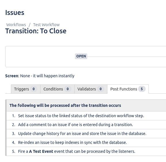

I just created a new custom event with template "Generic" (Admin>System>Events) and added this as a post function to a test workflow (Admin>Issues>Workflow>Transition:
It worked like a charm. Can you describe what steps you exactly did, so that I can help?

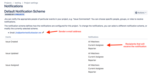

Professional domain '@MyCompany.com' - Atlassian outbound addresses? I was assuming that this notification would come from the single user email address I referenced above. Yeah, I know. THAT 'A' word.... :)
The e-mail address that will be displayed as the sender will be the one you set in the permission scheme (Check the screenshot below), however, the IPs of the outbound e-mails are the ones that will be used to send the notifications from JIRA, and that's how the addresses will be truly identified in the E-mail server:
Please, double-check if you have properly whitelisted the IPs of the outbound e-mails to properly receive notifications.
Additionally, Could you please send us a screenshot of how you are configuring your notification scheme?

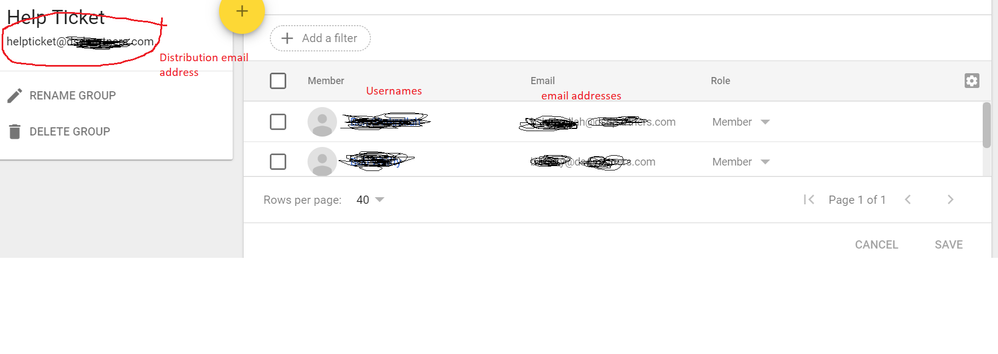

Bob Whitty
July 31, 2019
Ok Petter -
This covers the email group:
Bob Whitty
July 31, 2019
Sorry I had to break this up - couldn't seem to insert text below the screenshot. All the members of the email distribution are users under Jira Service Desk. 'HelpTicket' is not a user - only an email address. That said, I just noticed my Sysadmin set himself up using the HelpTicket email address so let me try again by adding him to the project.

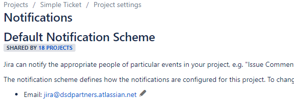

Notifications - the following screenshots cover your question:
Notification2.pngNotification1.pngWill be back shortly and Thanks Again!
