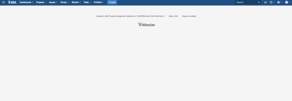

Hi! After clicking "configure" on the upper right side of my Kanban board I'm getting a blank page instead of the actual Configure dashboard therefore I'm not able to make any changes to my Kanban board. Does anyone know why this is happening?
Attaching screenshot of the blank page to ilustrate.

Thanks @Jack Brickey! Yes, unfortunately it's a persistent issue - happening for almost a month on all browsers I tried (Chrome, Safari and Frirefox)
it appears you are on Server. are you the admin? if not have you discussed w/ them? I wonder if some plugin has been added that is causing this. Are others seeing the same thing, again check w/ admin. Is this happening on all kanban boards?
sorry, don't have an answer for you at this point just a lot of questions. :-(
Hi @Jack Brickeyand thanks again. I am one of the admins and also the project lead :/ no other boards present the same behavior :( the Jira general admin is saying I might need to delete the board and create a whole new one but I really don't want to go through this...
there is something weird w/ that board for sure. recreating will be relatively easy and I think that is the only option. One suspicion I have is that the filter used to create the board has been deleted or made private. did you create the kanban board or someone else? if someone else can you check w/ them and see if they can view/config? if so check the share settings?
the person who created the board also can't view/config. I checked the filter used on the board and made it public (it was restricted to the team only before) but still getting the same problem :/
curious, how did you determine the filter used for the project. generally i would do that by going to the configure board settings but you can't get there. Assume the owner just knew it? For a quick test just create a new board w/ that same filter. shouldn't take more than a couple minutes to recreate/replace, right?
exactly, the person who created the board for me gave me the filter previously and it's saved on my list of favorite filters so I know which one it is. I'm not allowed to create board as per their permissions here but I shared your suggestion with the Jira admin, let's see! Thank you again! :)
