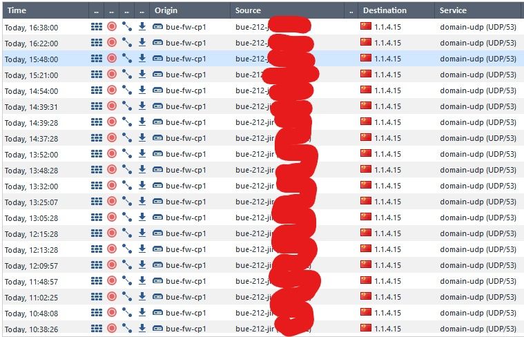

Comperndo, check this outbound traffic from our server to a server in China over UDP / 53. This is normal?
