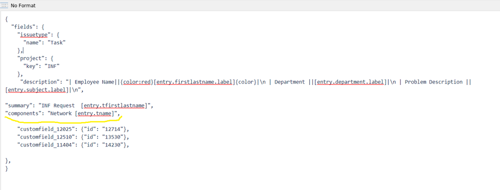

Hi All,
I'm new to ConfiForms.
I created a ConfiForms Form were the results are to be used to create a Jira issue using the IFTTT integration rules.
I'm getting error on System field "Component/s" and its a required field in that particular project.
Could someone help me how to describe JSON for that particular field?
3 answers
Alex Medved _ConfiForms_
June 8, 2021
Field names are case sensitive!
Components != components
You are also missing a comma after the "TestComponent1"}], <----- comma is missing

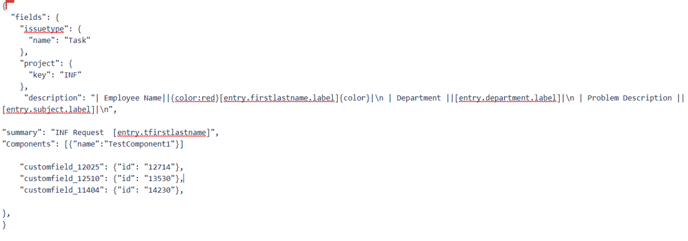

Prabhu Prabhakar
June 8, 2021
@Alex Medved _ConfiForms_  Thanks!
I edited the comma and adjusted the Components,
Still I'm getting the same error.
Could you please help me to resolve it?
June 8, 2021
You could not be getting the same error if you have changed the name and fixed the JSON mapping.

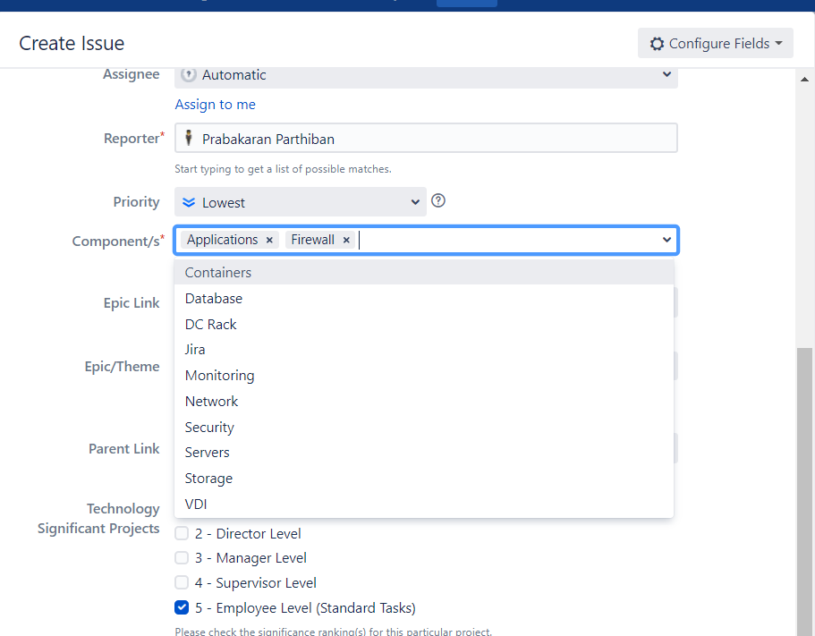

Prabhu Prabhakar
June 9, 2021
Yes I can see,
Please check the screen shot and components is system field with multi selected option and it's a required field for the "Task" issue type to the particular project.

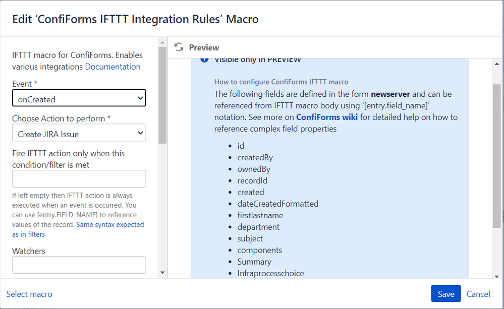

Prabhu Prabhakar
June 9, 2021
June 9, 2021
Sorry, but I was asking about the macro body, no macro properties...
Something what you have on your initial screenshot, but current
