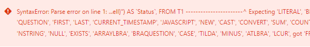

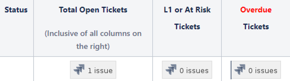

Hi,
I would like to insert a conditional formatting for the status of each project. So in the status column, i would like to fill the cell with a red color if the overdue tickets/total open tickets > 75% and green otherwise.
I have tried using table transformer with the following code:
SELECT *, FORMATWIKI("{cell:bgColor=" + CASE WHEN T1.'Overdue Tickets'/T1.'Total Open Tickets' >= "0.75" THEN "hex for red" ELSE "hex for green" END + "}") AS 'Status', FROM T1
However, I keep getting a parsing error as shown. This is my first time using confluence so any help would be greatly appreciated. thanks!

Katerina Kovriga _Stiltsoft_
July 28, 2022
Hi @Sophie Ng ,
I see that you have an extra comma between AS 'Status', FROM T1 (and your mistake points at this abstract as well).
