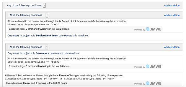

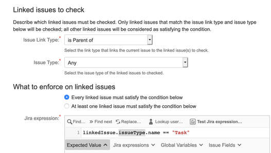

You'll want to use the new condition "Linked Issues Condition (JMWE app)". You'll configure it like this:
You would then need to add a nested condition to ensure the user is in the correct user role.
You'd then build the second set of conditions for the task/other project role. In the end, it would look something like this:
You would click on the fork to build the nested conditions.
What this screenshot shows is that you need to meet 1 of the two conditions, but for each condition you need to meet all the nested conditions. So, a parent ticket of type "Story" you must be a developer to transition. OR your parent could be a task in which case you need to part of the service desk team.
Hope this helps!
Kian
EDIT: Updated Screenshots to reflect correct condition configuration.

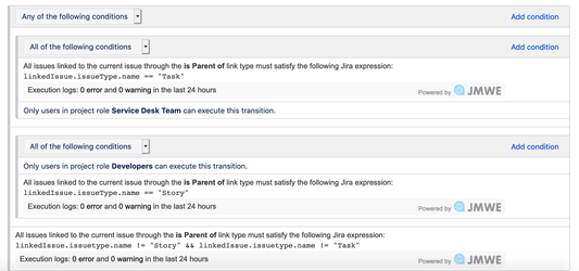

I think I see the confusion. I made a mistake in the conditions I showed you earlier. They should look like this: Screen Shot 2019-07-02 at 6.07.00 AM.png
In addition, if you have other issue types that don't follow this behavior IE, subtasks of bugs should transition without limitation, you would need to add an additional condition onto the bottom.

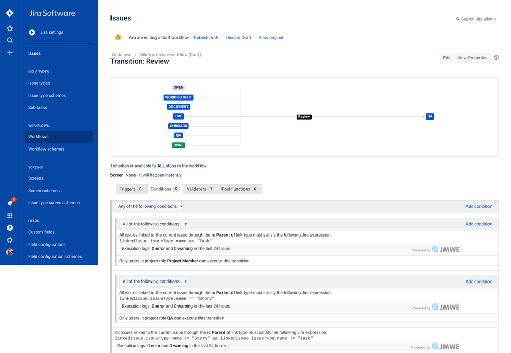

Hmmm, I'm still having issues.
To clarify the questions. Only users with project Role "QA" can move a subtask linked to a Story to the workflow staged QA.
I've doublechecked a few things to make sure it wasn't human error.
1. I made sure the changed workflow was published.
2. I made sure I removed myself from the project rule QA.
3. I was still able to move a subtask linked to a Story to the QA.
I also made a dummy user account and tested in case me having site and jira admin was allowing me to bypass. Also, when I drag and drop the subtask to QA the column displays a "loading" very briefly so I know I'm targeting the right stage.
Here's the settings. Is there anything you can see that I did wrong?
