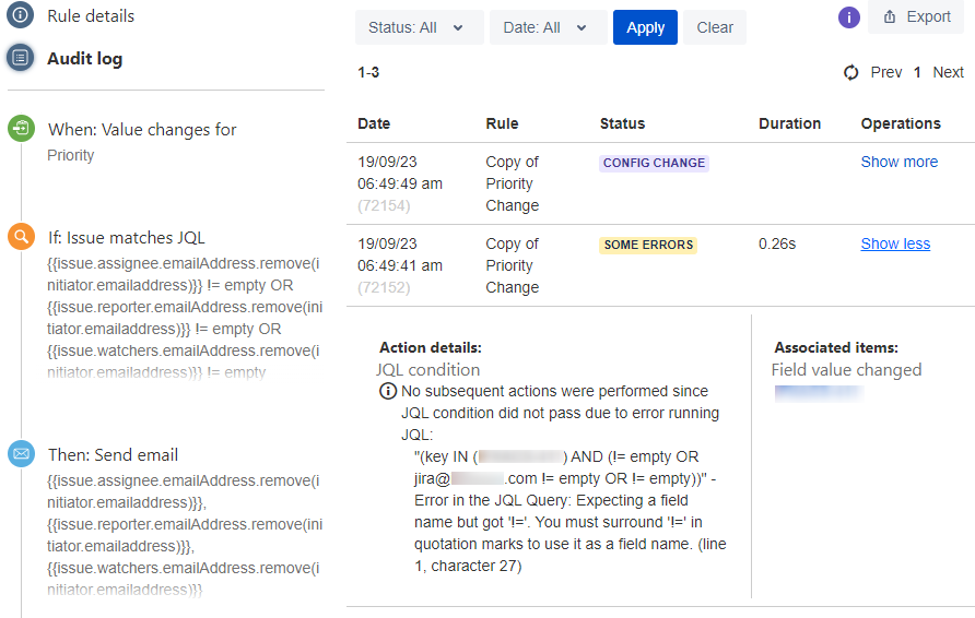

However I am getting the bug
(!= empty OR reporter@example.com != empty OR watcher1@example.com, watcher2@example.com != empty))" - Error in the JQL Query: Expecting a field name but got '!='. You must surround '!=' in quotation marks to use it as a field name. (line 1, character 27)
I am the assignee in my test ticket, and it seems this rule is removing my name entirely, so it is creating a bug. How should I fix my JQL, or is there an easier way to do this?

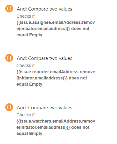

I also previous tried to do it via multiple Advanced Compare Conditions, but could not add OR functionality to this.

The issue is the JQL condition requires you to use well-formed JQL, and your use of smart value expressions on the left-side of comparisons can collapse to null.  With JQL, the left-side of comparisons must be a valid issue field.  Your audit log shows that you are trying to compare null (the absence of information) to empty, which cannot work with JQL.

Thank you for the suggestion. I tried doing it with Advanced Compare Conditions, but could not figure out how to use OR logic with this. I am trying to make the rule trigger when any one of the following is true, not when all three are true.
That is why I originally tried using JQL, so that I could use OR functionality.

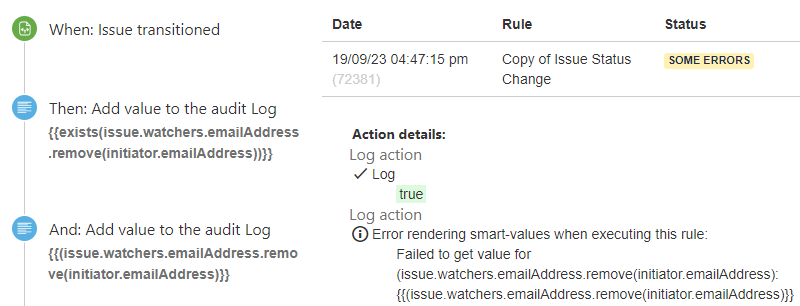

I tried this, but it appears that the EXISTS function is always returning true. In the screenshot below, you can see the first audit log evaluating the smart value existing as true, however the second log is erroring out even though it is trying to evaluate the exact same smart value.

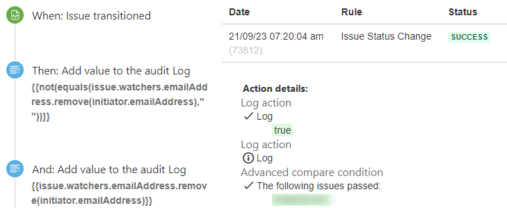

Sorry, spoke too soon. It appears that the assignee and reporter portions work correctly, but the watchers part still always evaluates to true, even if the value is empty.
I suspect this is because the assignee and reporter field are single user fields, and the watcher field handles multiple users.
In the below screenshot, there were no watchers but it still evaluates as true

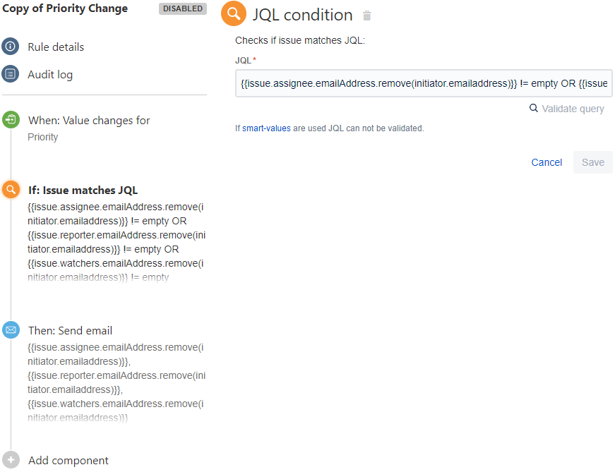

September 19, 2023
Thanks for the suggestion Marc. I was not part of the team who set up our Jira so I'm unsure if this is ootb functionality, I just know I have access to JQL conditions.
Here's a screenshot of the rule:
Here's a screenshot of the error:
