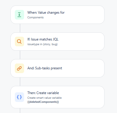

What I want
When a Component is removed from a Story / Bug I want to
  1. transition any linked Issues (of a certain link type) that also have the removed Component.
  2. remove the Component(s) in question from any open Sub-tasks that also have it.
My rule
Main branch
Trigger: Value deleted for the Component field
If: JQL: issuetype in (bug, story)
If: Sub-task is present
Then: A variable, "deletedComponents", is created for the deleted Component(s), with smart value:
{{#changelog.component}}{{fromString}}{{/}}

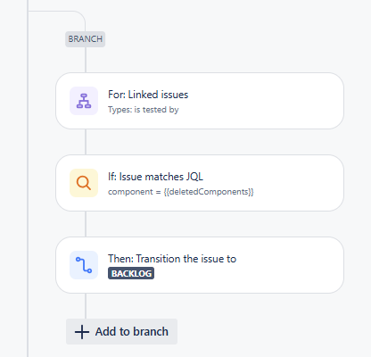

For: Linked Issues of correct link type
If: JQL: component = {{deletedComponents}}
Then: transition Issue

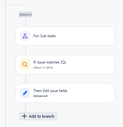

For: Sub-tasks
If: JQL: status != done
Then: Edit Issue, advanced editing:
  "update":{
    "components": [{
      "remove": {"name": "{{deletedComponents}}"}

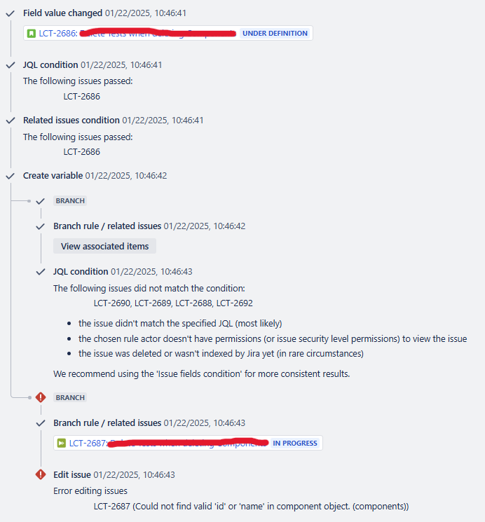

The setup works as expected if I remove a single Component from the Bug or Story, the problems start when I remove more than one Component:
  1. the first branch fails on the JQL condition: no Issues match the condition. But there are linked Issues with the removed Components.
  2. the second branch fails on the editing action: "[issuekey] (Could not find valid 'id' or 'name' in component object. (components))"".
So I printed {{deletedComponents}} and it turns out all removed Components are put together in a single string, e g comp1comp2comp3, which I guess explains why it works with a single Component but not more than that. comp1, comp2 and comp3 are existing Components and thus recognized but no component called comp1comp2comp3 exists.

Your created variable for deletedComponents has no delimiters.  To use it as Dick suggests, please change the Create Variable action's value to this:
{{#changelog.component}}"{{fromString}}"{{^last}},{{/}}{{/}}
That will use list iteration to surround each value with quotation marks and join the values with a comma delimiter, allowing them to work in the JQL:
 Later in the dynamic JSON, I would parse that to remove each value individually:
"update": {
"components": [
{{#deletedComponents.split(",")}}
{ "remove": { "name": {{.}} } } {{^last}}, {{/}}
Please note that because the quotation marks were already surrounding the values, they are not added to the JSON expression.

ad 1:  your condition if issue matches JQL should be component in ( {{deletedComponent}} )
The way it is now, you query for exactly one component. This fails when there are multiple.
ad 2: your JSON should be like (no quotes around the smart value and your variable does not end with s)
"update": {
"components": [{
"remove": {"name": {{deletedComponent.asJsonString}}}
If you anticipate multiple components to change, you would need the .asJsonArray as extension.
