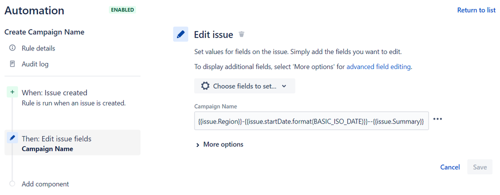

Thanks @Thuan_ Do Dang - I'm doing something wrong but I don't know what. Here is my syntax:
{{issue.Region}}-{{issue.customfield_12258.substringBefore("-")}}-{{issue.startDate.format("YYYYMMDD")}}--{{issue.Summary}}
It is populating this:
GL----Summary value
It was very difficult to find the custom field ID - what you suggested did not show it. I had to Inspect the page and search for it that way. But I found it and changed to substringBefore (instead of After, as you showed, because my example was not exactly how I had each value formatted in reality).
I am not sure how to write the Smart Value for the system field "Start date". I have tried entering an underscore between the words, leaving a space, and putting them together as you see above but nothing is being produced.
Regardless, my attempt is only showing the Region and Summary field values. It is not populating the custom field and date values between those two.
What did I do wrong?

Hi @Thuan_ Do Dang - This has gotten me closer!
{{issue.Region}}-{{issue.customfield_12258.value.substringBefore("-")}}-{{issue.Start date.format("YYYYMMdd")}}--{{issue.Summary}}
Now produces:
GL-TD---My Show
I don't know what is wrong with the date field and/or format syntax but it just will not populate anything. In my research, I have found that this format of date is called "BASIC_ISO_DATE". How can I reference that? Anything else I can try to get the date in that format? Am I referencing a field that cannot be used int his way - Start date?

sarah.wight
October 27, 2022
Hi @Thuan_ Do Dang & @Bill Sheboy - I found this article: https://community.atlassian.com/t5/Jira-Software-questions/What-is-the-smart-value-for-my-custom-start-date-field/qaq-p/1793650
...and viewed all of the fields on my issue to see if there was a custom field ID for the "Start date" field, which I had assumed (ah hah!) was a system field, not a custom field. Apparently, it is a custom field? Either that or every field actually has a custom ID????
Anywho, I found the custom field ID for "Start date", popped it in to my concatenated string, and after approximately 40 hours of researching, trial and error, headaches, complaining to my husband and colleagues, and working with you both: IT WORKED.
{{issue.Region}}-{{issue.customfield_12258.value.substringBefore("-")}}-{{issue.customfield_12007.format("YYYYMMdd")}}--{{issue.Summary}}
  • customfield_12258 = Campaign Type
  • customfield_12007 = Start date
Aside from the excessive development time spent on this, I would be happy with this final result save one small detail: "Region" is actually a custom field and I know that for a fact because I made it. So, for consistency's sake, why - WHY do I NOT need a custom field ID there, but I DO for Campaign Type and Start date? Please tell me there is a legitimate reason and I'm not just taking crazy pills. THANK YOU
