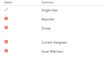

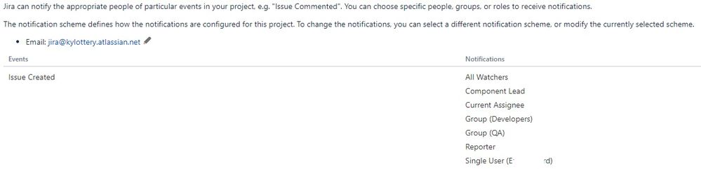

I have the Notify Component Lead set in the project's notification screen associated with the project, yet the Component Lead does not get the notification. When I run the Notification helper it indicates the reasons the user does not get the notification. Component Lead is not listed in the results as positive or negative. When I add him as a single user in the associated scheme, he does get the notification. Not understanding why the Component Lead is not enough for him to get the notification.

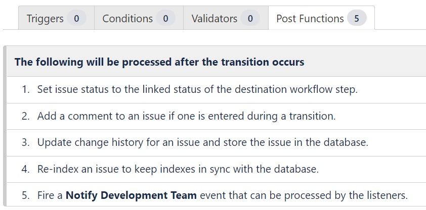

  2. When an issue gets created, the associated workflow should effectively throw the Issue Created event. In some cases, this is a generic event instead, and so the notifications aren't triggered. Have a look at your workflow and more specifically the create issue transition. The last post function of that transition should be the event that is being thrown.

  2. Snapshot of post functions below
  5. The Notify Development Team event does work
